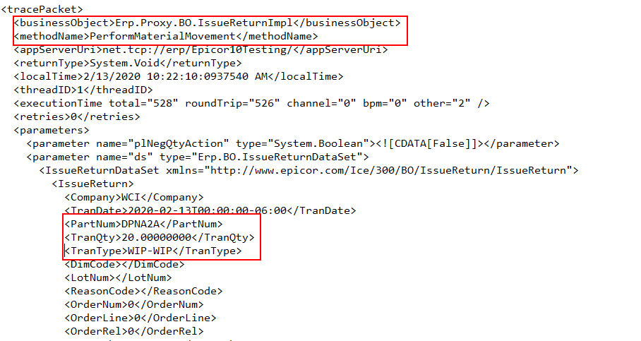

I don’t believe there is, but does anyone know if WIP-WIP transactions are logged anywhere like normal PartTran transactions are? When you move WIP with AMM it still goes through the IssueReturn BO and PerformMaterialMovement method but as a WIP-WIP transaction. Nothing in PartTran for them.
Try searching for MFG-WIP transactions. I’ve never seen WIP-WIP in PartTran but I do know the MFG-WIP is used for issuing from one job to another so it might be what you’re looking for.
I’m looking specifically for WIP-WIP ultimately we have worked around it with some BPMs as sadly it doesn’t look like it’s supported otherwise. Epicor appears to perform WIP-WIP the same as all other transactions except they don’t create the PartTran record.

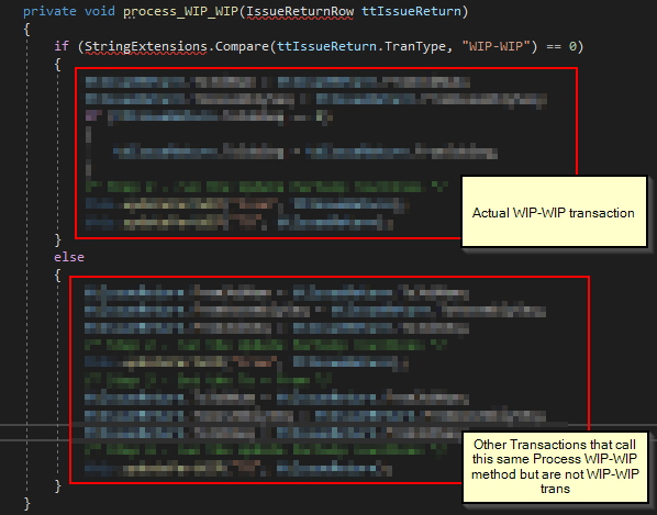

Curious what that Method is actually doing with this.
Might not help you much but it would be interesting to setup a SQL Profiler Trace when you run this transaction to see what SQL is actually executed. I wonder if they are just using the transaction data to clear PartWip or something.
Is it possible that since WIP-WIP is a non-inventory part tran, and the debit and credit would go to the same account (for a “null” GL transaction), it just doesn’t create a part tran record? Like how zero dollar items don’t create GL transactions.
@Rick_Bird correct they are simply doing an update on PartWip changing the BinNum field and that’s it. The source is about 5 lines long for WIP-WIP
The transactions that call this same method are DMR-ASM, DMR-MTL, DRM-SUB, INS-ASM, INS-SUB, MFG-OPR, MTL-MTL, and PUR-SUB if anyone is interested lol.
