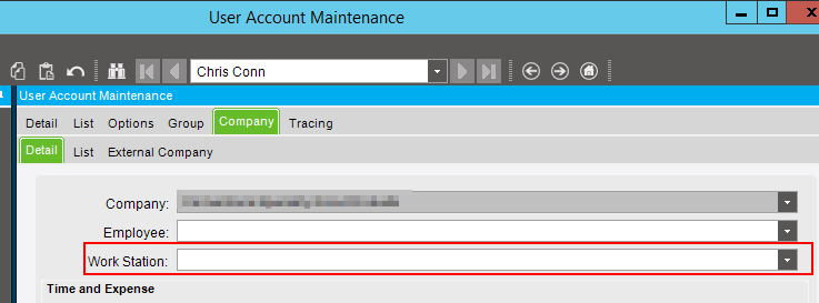

UserComp.WorkstationID
Thanks Brian! My understanding of that one is the workstation assigned to the user but not necessarily the one they’ve picked when logged in to Epicor correct? What a PAIN
Maybe I don’t understand, but you are looking for the WorkStationID that is setup under Shipping/Receiving?

I did some testing and when you change workstations the UserComp.WorkstationID is not updated until you log out and back into Epicor.
Thanks Brian,
I tested again @litzer67 suggestion and that does get updated when you switch. Thanks again all of you!
