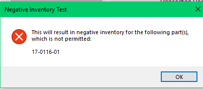

I appreciate the quick follow-up Zack. This is what I get when I try to unreceive the inventory:
It appears that I am incapable of unreceiving the PO. I’m also unsure of how to “void” a PO?

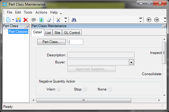

Check the part class assigned to part on the PO. Negative inventory its handled at the part class label. I think the options are Stop, Warn, None.
The error message you posted looks odd though, so you may have a custom BPM that is preventing negative inventory. Of you’re familiar with BPMs in your system, you could simply disable it. If your not familiar with BPMs, this could be more difficult, so…Option B…

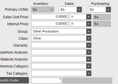

Is the “Class” field in Part Maintenance what you are referring to? While there are a lot of options, there are none that state “Stop”, “Warn”, or “None”. Unsure of what category I am looking for, and also how this effects the negative inventory.
If I’m in the wrong place, please let me know. This is all I could find!
Thanks all, I figured out how to make a class and turn off the negative inventory reaction. I was able to unreceive the PO, edit the PO, rereceive and invoice it.
