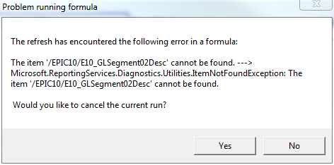

On this one, the Epic10 I created about a month ago and nothing ws supposed to be attached to this. Apparently, the XL Connect was attached to it. How do I fix this?
Ok, I got to looking at it and it appears I picked name for a test report server that was identical to one already existing. And that one was for the XL Connect. So, how do I fix this?
Fixed. Had to go to the XL Connect install and install the report server.
