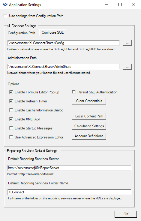

I usually click on the Application Settings and I uncheck the Use settings from Configuration Path (I’ve never been able to use a central Configuration file so I just fill this in manually maybe you will have better luck? I worked with someone from Epicor once and they never really suggested another way. So this is how we do it. - Now I have that song stuck in my head! :love_you_gesture::smile:) and fill-in all of the needed information that opens up.

Once the Application Settings are complete, save them and click Scan for Content
Be sure to say “No” to use current settings and to not wipe out your Application Settings that you just inputted.
