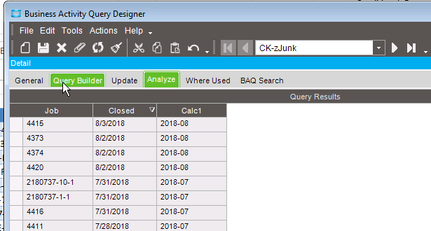

But the following would work in a BAQ
LEFT(CONVERT(varchar, JobHead.ClosedDate, 23),7)
Format 23 is yyyy-MM-dd
Does MM preserve the leading 0’s? That’s needed for sorting purposes when sorting numbers set up as NVARCHARS, (otherwise 22 comes before 3 etc.)
edit, looks like it does! Nice.
Apparently so…
And I ALWAYS format dates as yyyy-mm-dd, when it will be used electronically. Even in files names.
