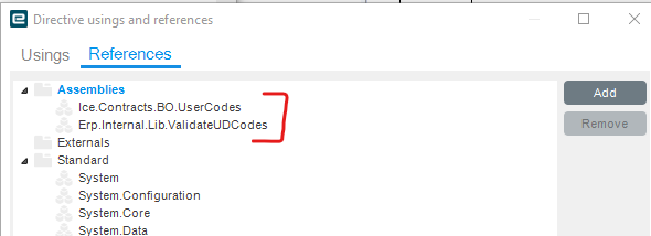

Yet again, am I missing a using or reference?
K22 Multi-company, multi-plant.
I’m trying to follow this example where conditionally a UDCodes record is created.
As soon as I add the line with the ServiceRenderer GetService, I get "The type or namespace name ‘UserCodesSvcContract’ could not be found (are you missing a using directive or an assembly reference?) and yes I probably am but which one? My references screen looks like this; adding these entries doesn’t seem to have helped.
And I have added these “usings” because they sometimes help with this error, but not this time:
using Ice.Tablesets;
using Erp.Tables;
Can someone point me in the direction of what’s needed here? The line of code I’m trying to get to work is:
var boUserCodes = Ice.Assemblies.ServiceRenderer.GetService<UserCodesSvcContract>(Db);
Best,
…Monty.
GetService<Ice.Contracts.UserCodesSvcContract>(Db)
or add
using Ice.Contracts;
Like buttah! Thanks a bunch.
