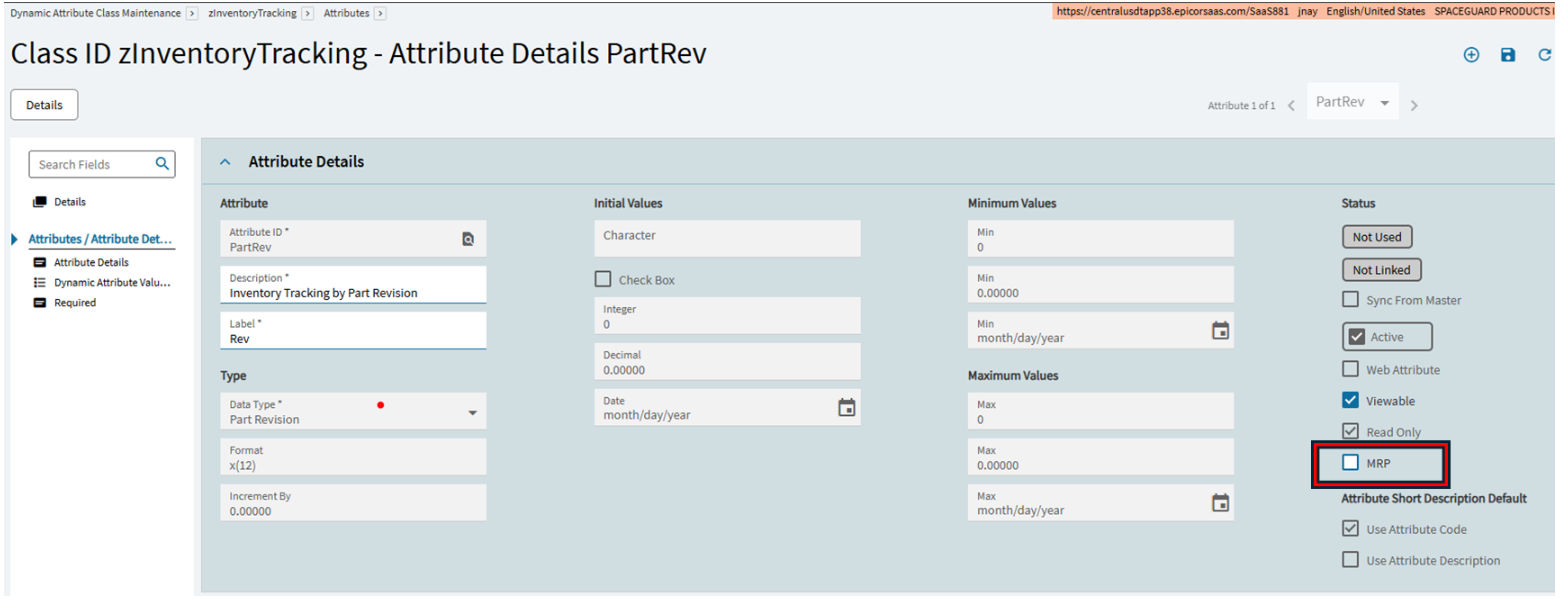

We use Track by Revision extensively in our system. On the last 3 major upgrades the System Class ID zInventory Tracking Status MRP has been switched from TRUE to FALSE. Field DynAttrClassDtl.UsedInPlanning
Anyone else use this “feature” and have this issue?
Epicare claims its nothing they are doing and that we have a BPM that is somehow triggered by the upgrade. I have to request a datafix after each upgrade to correct the issue.
