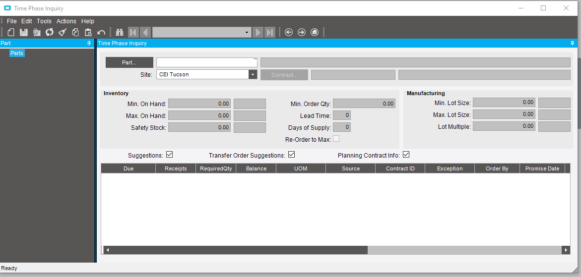

I am now looking to add this same Part ZoneBAQ to the Part field found in Time Phase Inquiry.
I’ve tried implementing it using Extended Properties and the Customization wizard, but no success.

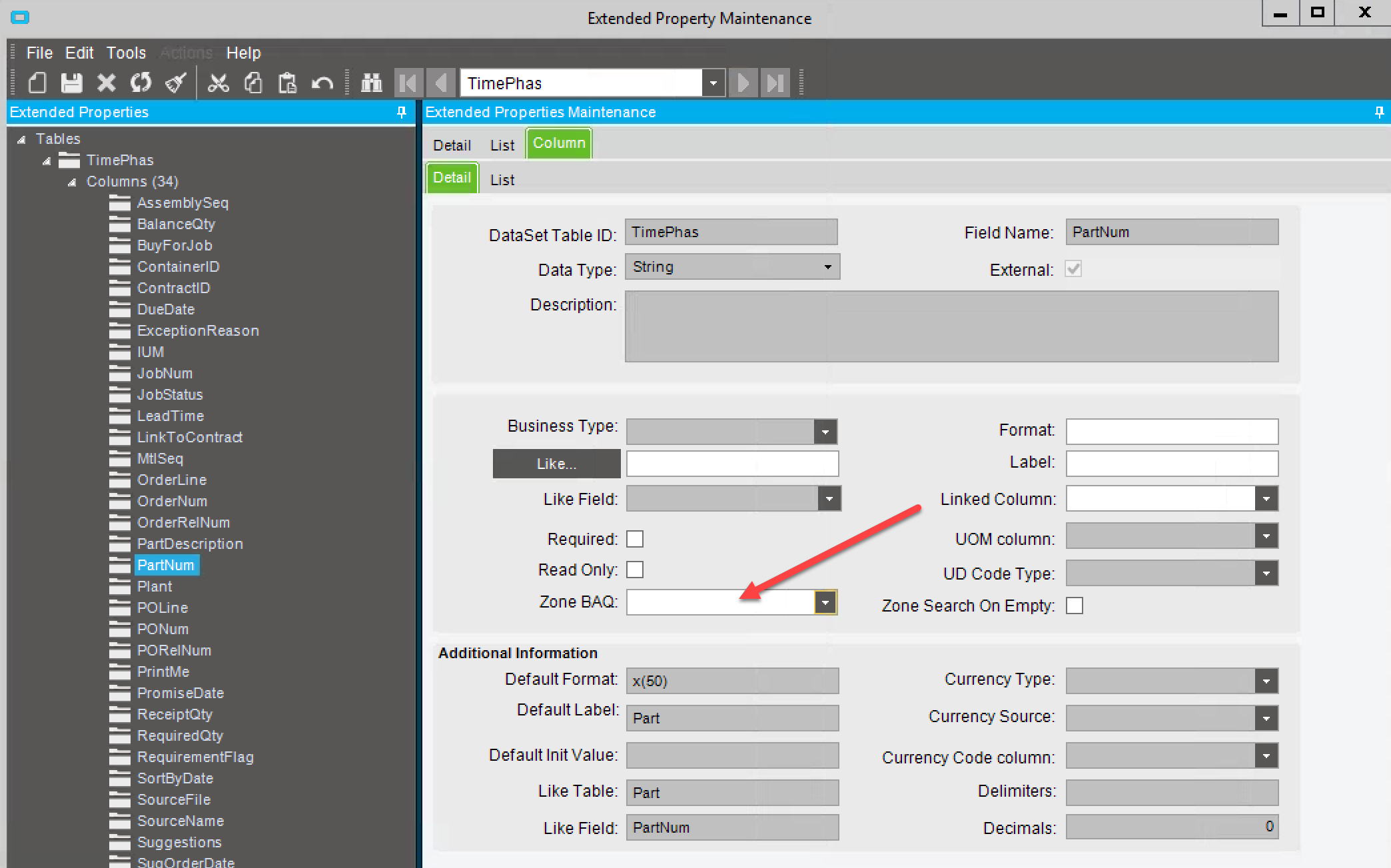

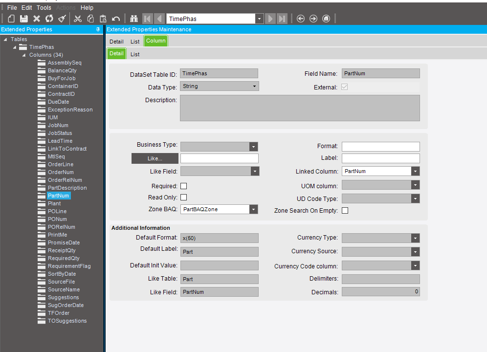

Time Phase Inquiry is one of the Forms that incorporates Logical Tables and you will need to add the Zone via UI Customization. From Customization mode on the form, go to Tools>Wizards>Customization Wizards>Modify Extended Properties and Launch the Wizard.
The data view for the Part field on that form is “Misc” and the Data Field is “PartNum”. The Extended Prop should be ZoneBaq and then select your Part Zone BAQ.
I assume that you are using the “Like” Markup on the BAQ and the Misc.PartNum binding is defined with a like of Part.PartNum so I would expect the BAQ to do the expected filtering.
