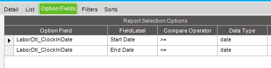

Not sure if you would know the answer to this but when a BAQ is run from a BAQ Report Designer and has a date range selected will the full query still run or will it only run for that query date? I am asking since the 1/3/5 year sum would not calculate properly if it is only bringing in the date range selected by the option fields(i.e. last week).

You’d need to pull the whole set of data from 5 years ago. You’d use the parameters to populate another calculated field. For example
case when [DateField] between @StartDate and @EndDate
Note that I don’t 100% recall how BAQ Reports pass those option fields back to the BAQ.
Also, if they’re already wanting hardcoded 1/3/5 values, you might just want to hardcode the short term numbers too. Don’t give them any options. Just do (for example) this week/last week/MTD/1yr/3yr/5yr, etc.
Most of the time people don’t want to plug in a date range. They’re looking for a specific relative time period every time they open it up.
I wish they would let me hardcode all the numbers. They enjoy their flexibility on what information they pull outside of the 1/3/5.
