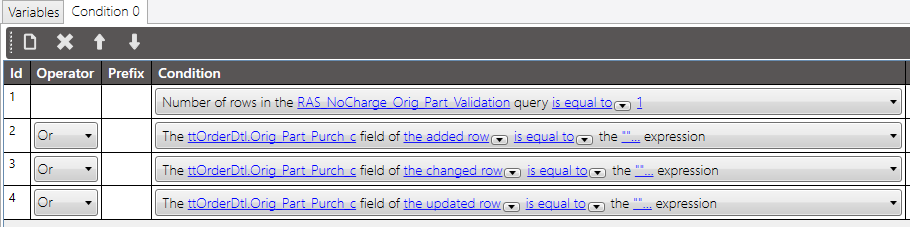

Condition 1 = Number of Rows in the query (ttOrderDtl.Company = Erp.Part.Company and ttOrderDtl.Orig_Part_Purch_c = ERP.Part.PartNum) is equal to “1”
Condition 2 = The ttOrderDtl.Orig_Part_Purch_c field of the added row is equal to the " " expression
Condition 3 = The ttOrderDtl.Orig_Part_Purch_c field of the changed row is equal to the " " expression
Condition 4 = The ttOrderDtl.Orig_Part_Purch_c field of the updated row is equal to the " " expression

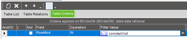

Are you filtering your rows by the row mod in the first part of the condition? Sometimes there are two rows, one with a row mod, and one without (the existing one). That will mess up your query tests if you don’t filter out for that.

@Banderson Do you mean adding a table criteria to “ttorderdtl” in reference like so:
And i’m not that savvy when it comes to C#. Could you provide an example please?
edit, yes. (sorry if you saw the other stuff, your screen shot didn’t have all of the stuff so I got confused)

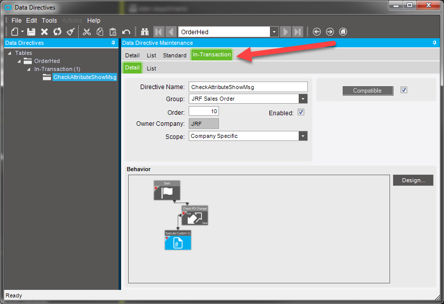

Perhaps you already know, but there are 3 basic entities that you can use to accomplish these kinds of tasks. Form customization, Data Directives (database update monitoring), and Method Directives (monitors before or after a business object method fires). Both data and method directive act server side, so this has some distinct advantages in certain scenarios. BPMs are also much easier to maintain/deploy in most scenarios. I think this particular case could be solved very easily with a Data Directive because you are monitoring a bound field’s value changing.
I have an example of a data directive I use to monitor the field value of the OrderHed.PONum field.
This one is a n-transaction directive, meaning that it’s not been saved to the database yet and gives us an opportunity to intercept the data if needed.
In my conditional block, I have two things it’s checking. The first is that the PONum field changed from any to another (which also works for you, since by default your field will be empty and this condition will only be checked if the field changes to something else) and that the number of rows in a custom query is not less than one (I’ll explain in a second).
My queryinner joins the ttOrderHed table with Erp.CustAttr in this case, but you would join it to your Part table on the appropriate fields.
You would want to join on Company to Company and OrderHed_YourCustomField_c to PartNum. If there is a valid value in the YourCustomField_c field, then an inner join will be possible and should return at least one row.You would also want to change the “is not less than” to “is less than 1” if you plan on triggering the condition.
If there is not a valid value in that field, then no rows will be returned from the query. If this is the case, you will positively fail the conditional check and you should then attach an exception box from the TRUE side of the conditional check.
Give that a shot and let me know if it didn’t work

You query should only look at the record with ttOrderDtl.RowMod != “”.
Also, you only need the “changed row” condition. This covers “Added” and “updated”.
Thanks for the help everyone. After reviewing the original method directive I created and updating it to meet the specs of “RowMod” and only using “Changed” the directive passes all my test cases.
