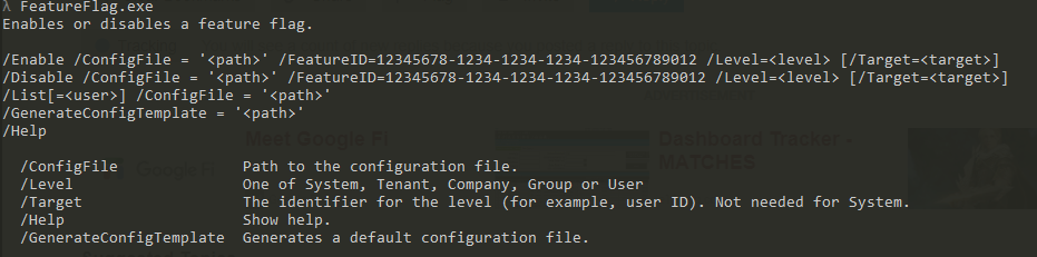

FeatureFlag.exe
If anyone is interested 10.2.300.x
Add to your .sysconfig

FeatureFlag.exe is located within your Client Directory.

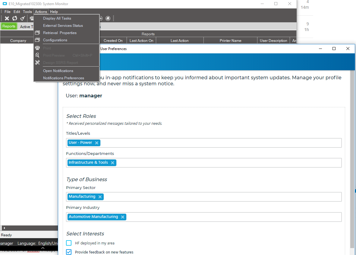

# Enables In-App Notification aka Push Notifications, once you logout, login you will be prompted to register
FeatureFlag.exe /Enable /ConfigFile=Config\E10_Migrated102300.sysconfig /FeatureID=79479C59-021B-40C4-A8D3-2F859FD8CD6B /Level=System

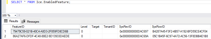

It will write a record to SQL.
Once you logout and log back in, you will be prompted with a Register/Subscribe Dialog.
The In-App Notifications is a Kinetic App that runs as a hidden window and you can make it visible via the System Task Agent Actions Menu (once FeatureFlag is enabled).
