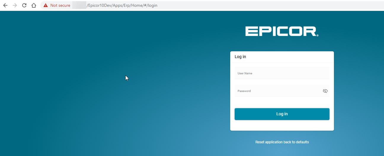

In my dev environment, everything’s working great. In my test environment, I am unable to access any kinetic form.
When I naviate to the active home page URL, dev works but test does not.
Dev:

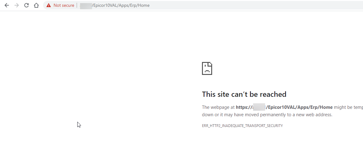

Test:

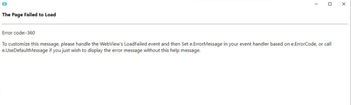

Attempting to open any kinetic form in the test environment gives this error:
I have a feeling this is an IIS setting but not sure where to look as at first glance, both look similarly configured.

Noticed it’s the same with the API help pages. The Dev server works just fine whereas the Prod server kicks back the same error: ERR_HTTP2_INADEQUATE_TRANSPORT_SECURITY
Interesting; the URL for the Test environment works just fine in Edge but not chrome
Its using a lower (too low) TLS version. Probably your server just needs an update
Chrome is mighty bitchy about that stuff.

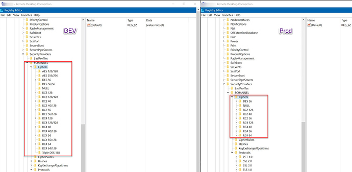

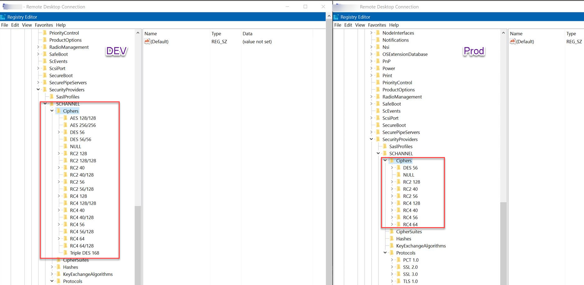

Well crud, TLS 1.2 was already enabled and the server rebooted but the same result persists. I also tried swapping out the ssl cert bound to 443 on Epicor, restarted the website, recycled IIS, but same results.
We did notice there are far less ciphers in the registry on the production server than on the dev server, and all works well on the dev server.
Is it perhaps we that we need to add those ciphers to the registry on the production server?
