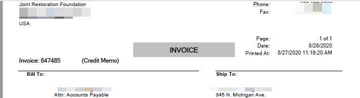

Stock report:

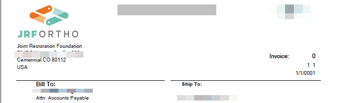

Customized:
Keep in mind this is a minorly customized form (Added a logo, a static text field, and a lot number field) that has been working for years and years and only minor upgrade changes needed for new versions. I am obviously venting a bit but this is honestly ridiculous.

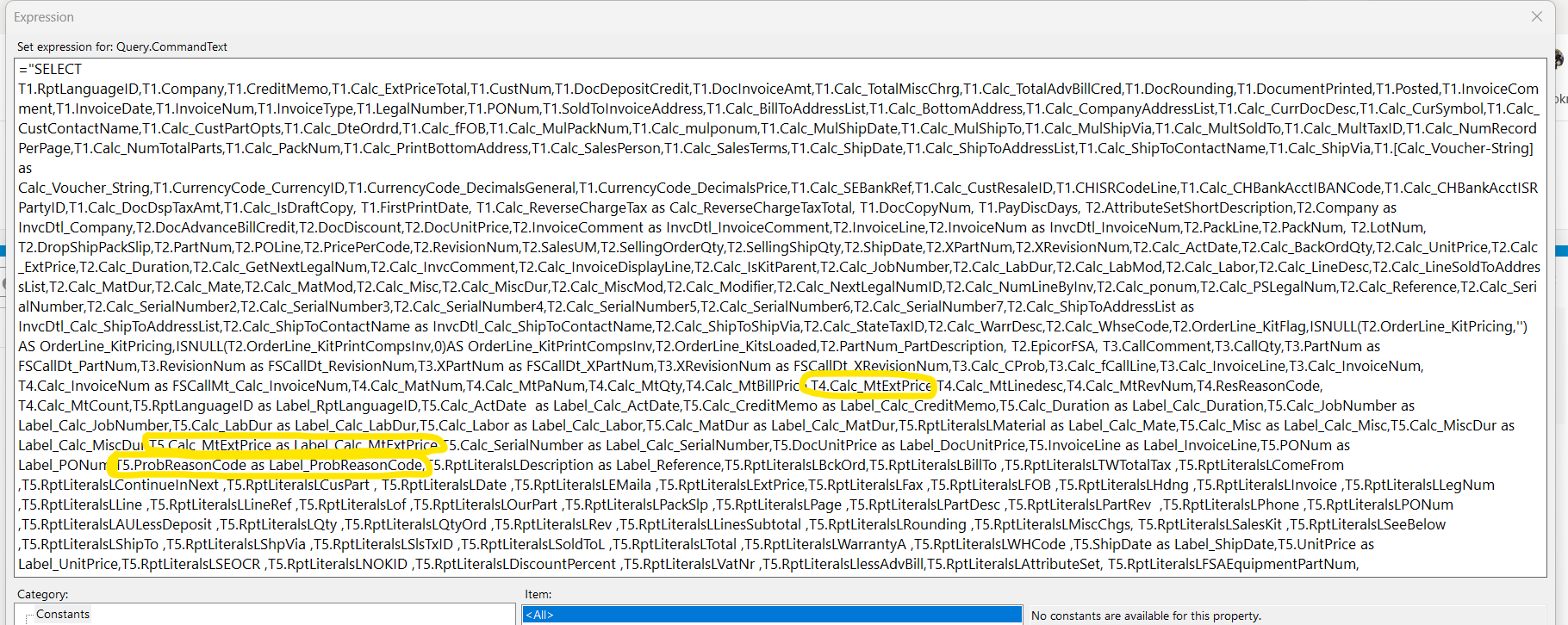

In case someone stumbles on this…
The KB article is not complete… I needed to delete 3 fields:
T4.Calc_MtExtPrice
T5.ProbReasonCode as Label_ProbReasonCode
T5.Calc_MtExtPrice as Label_Calc_MtExtPrice

I also had to remove the same 3 fields from the ARForm Query then reupload the rdl
T4.Calc_MtExtPrice

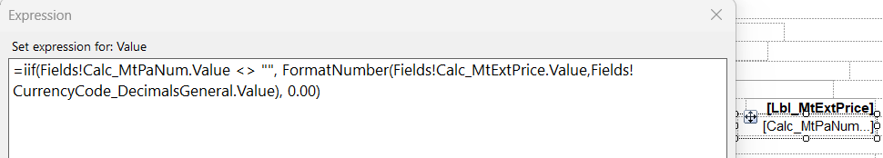

I’m feeling stumped - 2025.1 upgrade and expected to delete these fields… but they’re in use on the ARForm (fields in the detail group of the report)? When I run/review the Standard - SSRS they’re in use there too.
Are you only removing the reference to these fields in the dataset or are you also removing them from the SSRS report design?
I am removing them from the SSRS report using MS Report Builder

  5. Select Datasets → ARForm
  6. Right click ARForm, select Dataset properties
  7. You will see Query . Click the Fx button to edit the Expression
  8. Remove the three fields manually.

See, that’s what I expected to see, and what I recall from past upgrades, but the report itself has text boxes referencing those three fields:
I am seeing the same field references on the Standard - SSRS .rdl file too.
