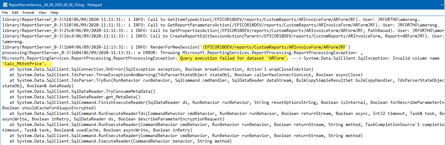

In the end we didn’t have to rewrite the form completely. Although the same form was uploaded into both Production and Pilot the error message received was different, in Production the error was non specific
  • Query execution failed for dataset 'ARForm
but in Pilot the error was
  • Query execution failed for dataset ‘ARForm’. —> System.Data.SqlClient.SqlException: Invalid column name ‘Calc_MtExtPrice’. Invalid column name ‘ProbReasonCode’.
Removing those two fields from the query and re uploading it resulted in our form functioning again
That’s exactly what it was for me to.

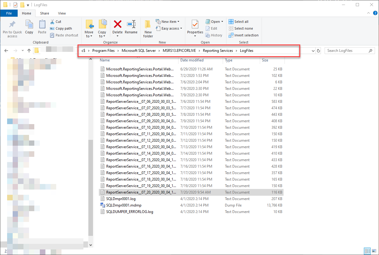

I got the non-specific error Query execution failed for dataset ‘ARForm’.
Looked in the log files for the specific reporting server instance and it shows more details about which field was failing

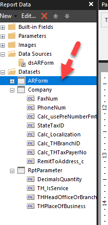

From there, I navigate to the actual RDL associated with the Report Styles that consume it, in my case a custom RDL called ARFormJRF and open with report builder. Modified the dataset for ARForm.
Open the query phrase and removed the two references to a field “Calc_MtExtPrice”, saved, and re-ran the report with success.
@Aaron_Moreng How did you get that Log info? That would make my job a lot easier!
It should be on the server where your reporting server lives and then just dig down to the appropriate instance of the reporting server and go to the log files.
