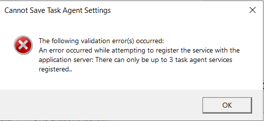

Anyone know where to look for this?
There are no registered task agents. At one time, there was one, and it was working. There were never 3, this is a brand-new server and only has 2022.1 on it.
Any thoughts anyone?

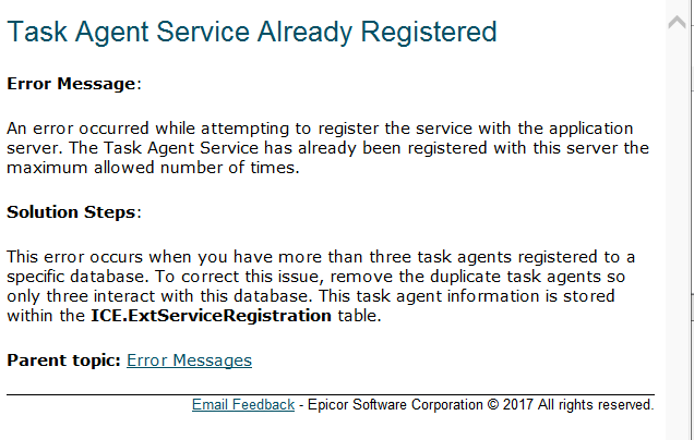

ok, well TA help has:
And that table has:
with 3 server names that have a lower version of epicor because this is an upgrade-in-place
So I guess delete?
helluva yucky feeling but it worked…

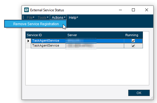

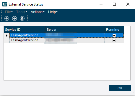

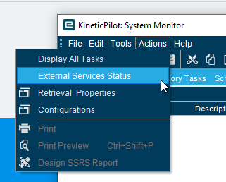

Look here in the system monitor:
Select the agents that aren’t related to the Kinetic installation and then go to Actions->Remove Service Registration
I don’t see a place to do this in the Kinetic side, but you can in the classic…
That’s what I did with a UBAQ… It was a test system and all…
