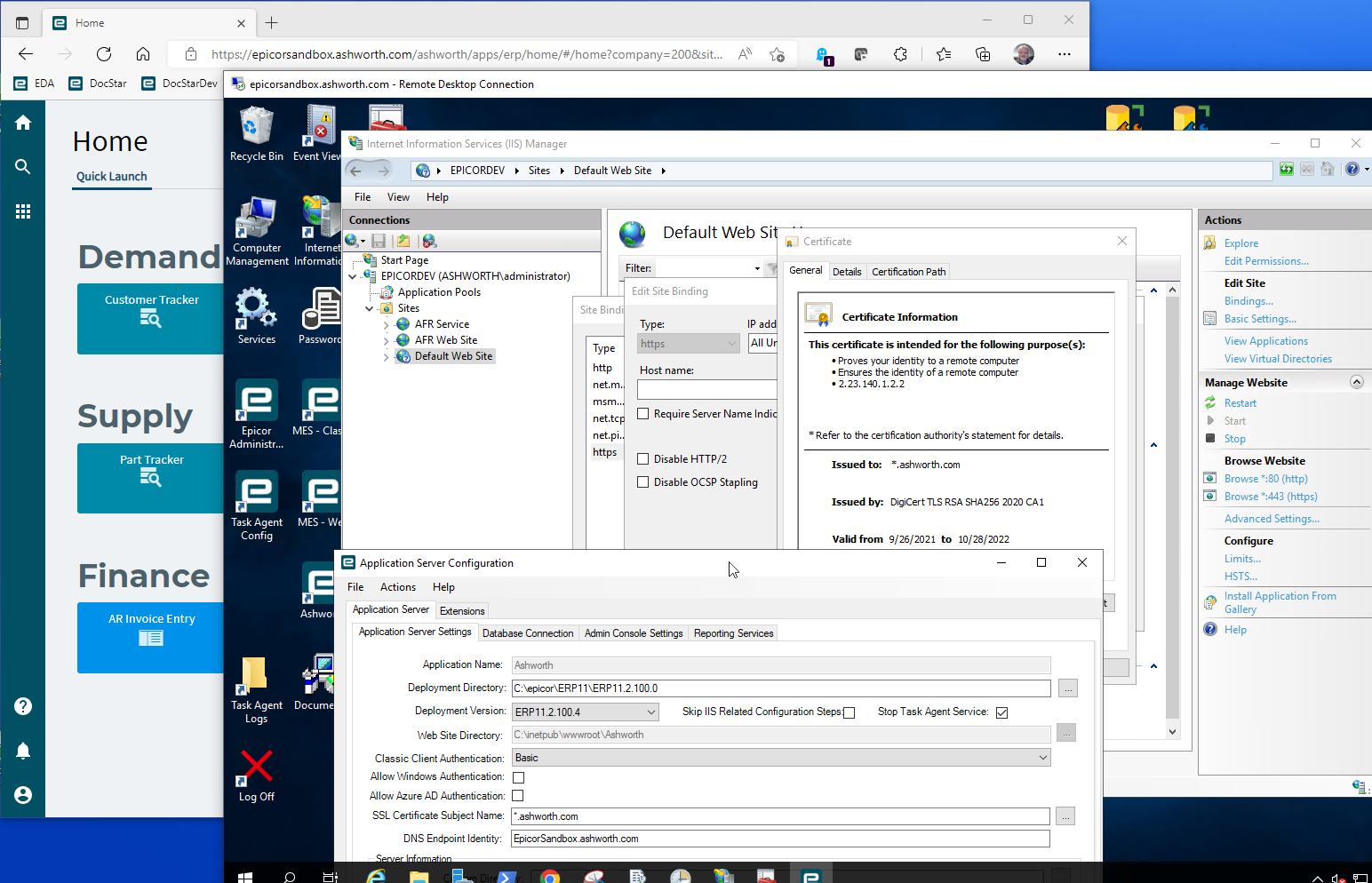

If you have an on-prem setup using RDS / RemoteApps instead of clients, you need a self-signed certificate from your AppServer installed on each TS. You ALSO still need a public certificate if you have anything connecting from outside, like SalesForce making Epicor API calls. In order to make this work, you need the self-signed certificate binding on port 443 WITH server name and the public cert binding separately, WITHOUT server name. This is all assuming the old-fashioned server.domain.local naming convention.
Don’t use IIS to create self-signed certificates - they don’t work with this setup. Use Admin Console to create the certs when you create the AppServers.
