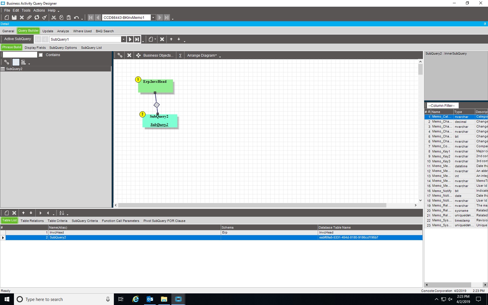

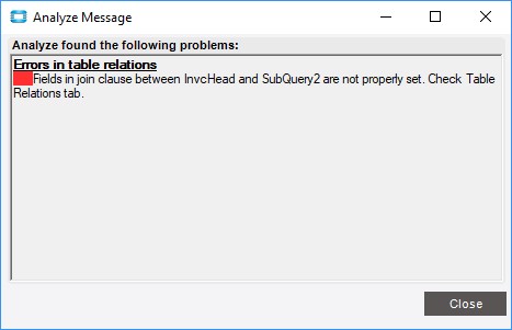

Not sure if it is the ICE.MEMO or what but it will not allow me to link to ERP.INVOICE HEAD. I keep getting table relations errors and cannot create a manual link. Any suggestions?
Whats your JOIN look like and whats the specific error.
