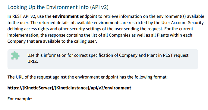

In 2021 we use environment all the time to figure out (via API) which Company plant etc a use has access to. The Help in 2023 says it should still be there, but we are getting 404. I’ve tested in two different systems with the same result.

It looks like it was removed somewhere in 2022… However the REST API Guide still shows it.
Yeah so the entire Environment Controller has been removed in 2023 (and maybe prior) which leaves no way for you to get a list of user’s Companies / Plants in V2 without hacky work-arounds.

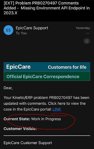

Opening a support ticket on this but i guarantee you they’ll tell me to submit an idea.
Update Case: CS0003828367
Sorry Jose
or… has it… :smiling_imp:
Thanks for the case number. I’m tracking this internally and I can assure you it is being treated as a regression, not a new idea.
