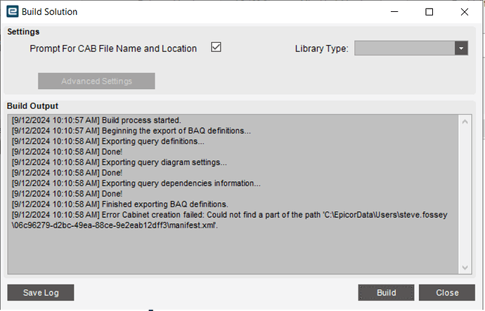

Have done a pile of issue resolution and decided to do another build. Started collecting up issue resolution items in CABs and immediately ran into a problem:
I initially ran into this in the Kinetic version, noticed there was no option to prompt for CAB location, used menu to switch to classic version, notice options are missing.
I’ve checked or tried:
  • my permissions are correct;
  • my groups are correct;
  • restarted, regenerated, recycled, etc.
  • EpicorData folder permissions appear correct for all the service accounts;
  • 2022.1 instances work fine;
  • printing works fine;
  • processes run and save logs in EpicorData;
  • process successfully saves solution workbench error log in selected or default location;
  • found a reference to changing the System Agent client program directory from a local path to a network share path using a direct database update, but it didn’t change anything and in fact overwrote the server and client data directory paths too. Reverted.
  • Error doesn’t write anything to the Event Viewer.

This is fixed in a patch update. I am not sure which one I’m afraid. But .8 has the fix in it.
The issue is the period ‘.’ In your username. A workaround, if you cannot patch up, is to run solution workbench under a user with no period in it.
The bug was introduced as part of the roll out of Kinetic UI solution workbench. The processing has been moved server side.
You’ve got to be kidding me… but yeah that was it.
Thank you a million!

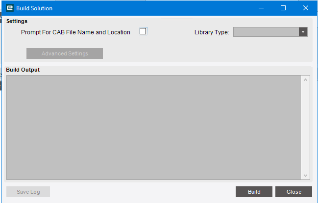

I’m going to ask what happened to the additional checkboxes. Create documentation and encrypt?
I think there’s a section called advanced settings, maybe a button to access them?
In Kinetic / Browser it gets tricky due to Edge Agent but it seems to be feasible.
In classic it’s disabled on 2023.2… I have full rights to everything. I’d like to know what controls the enablementness of that advanced button…
On Prem so unless it is related to the Global Security manager, but I thought that was only cloud.
On 2021.2, we had an issue here on-prem that required us to enable Global SM for some reason, so you may have something there.
@Mark_Wonsil Going to act dumb here but where is that setting?
EDIT:
Disregard. It’s a hidden field in Classic you need to enable it in the list view.
I think this is it. Open Epicor Admin Console, go into the app server/users, select the user (usually manager or epicor) and enable:

Nope still greyed out
