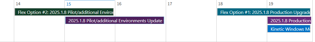

Indeed! Our Cloud PILOT is scheduled to be upgraded to 2025.1.8 tomorrow and LIVE is scheduled to be upgraded to 2025.1.8 this coming weekend!
We just had out Flex 2 upgrade to Pilot and are seeing this. This is a huge issue across the board. All grids, landing pages and dashboards over a page or so are broken.
