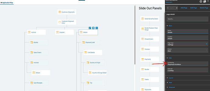

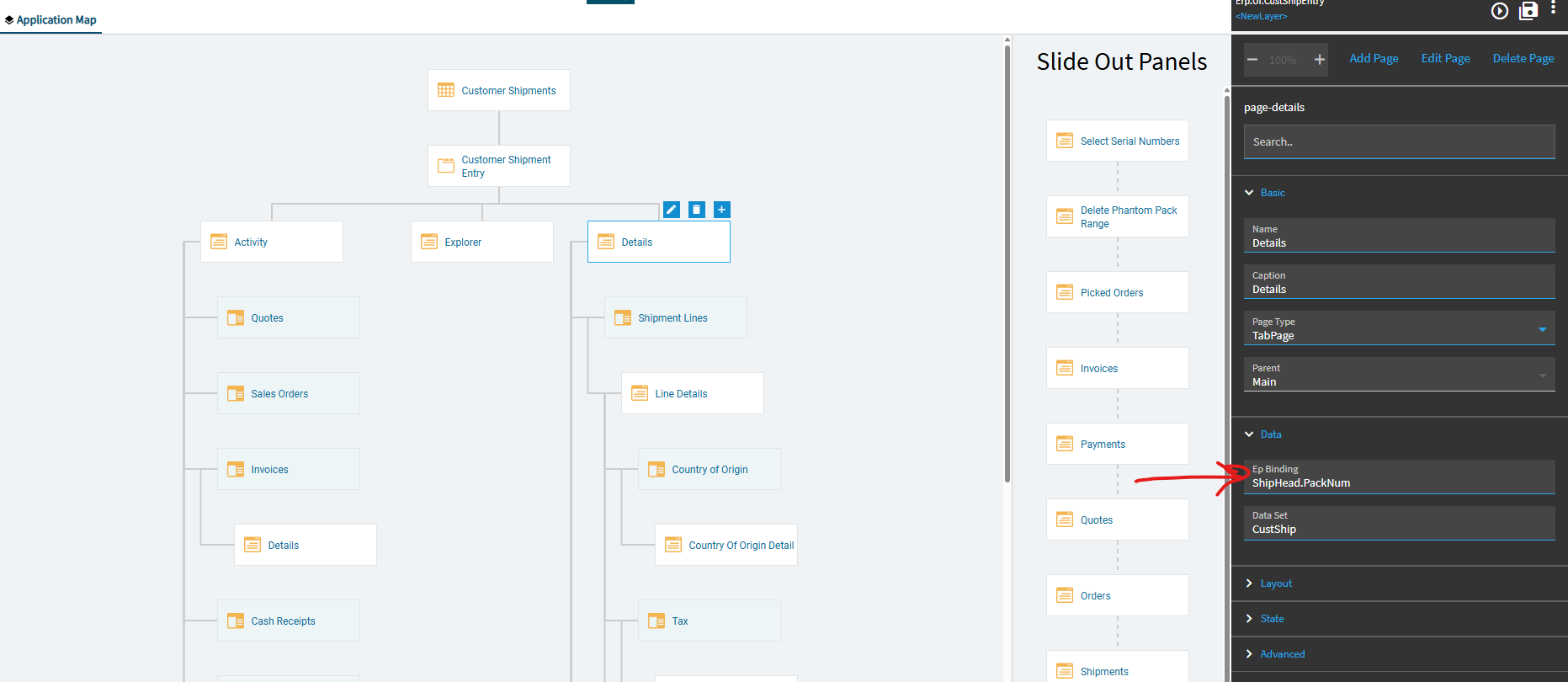

Do you have customizations on Customer Shipment?
Open it in App Studio. Click on the pages in the Application Map and see if they have missing Ep Bindings.
I haven’t seen this yet in 2025.1, but it happened a good bit (sporadically) in 2024.
No, no customizations on Customer Shipment Entry.
I checked the App Studio, Application map and I DO see Ep Binding where you indicate.

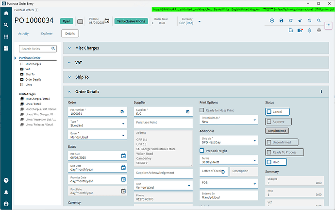

Noticed on a screen customisation on PO Entry we have done that the sections are in the wrong order.
If i go into Application studio to move them around, it just locks up!
