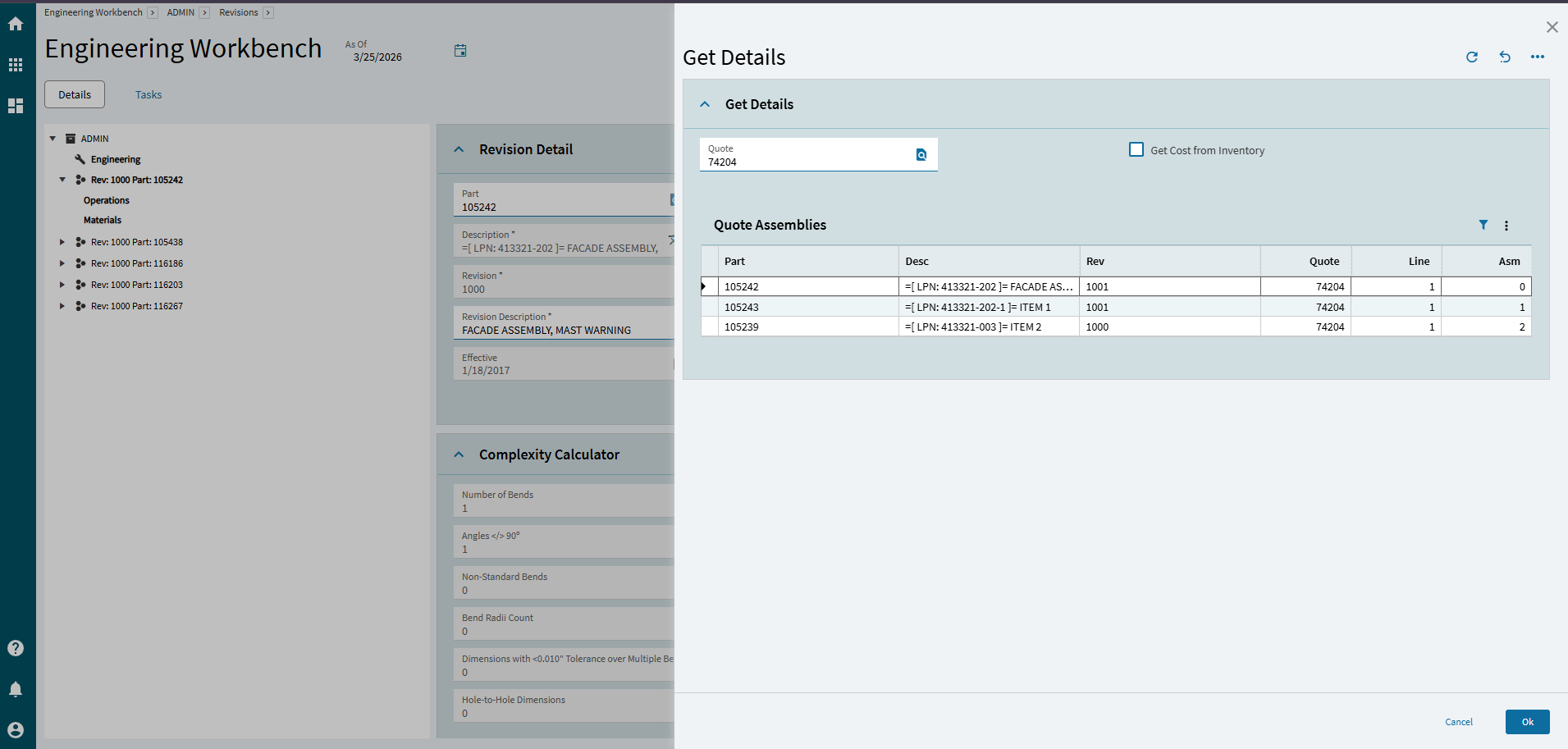

Since then, we’re noticing strange behavior around Engineering Workbench’s GetDetails process. Back on 2024.2, GetDetails from a Quote would show the 0-level assembly as well as subassemblies once a QuoteNum was selected.
Pictured below in our remaining 2024.2 environment:

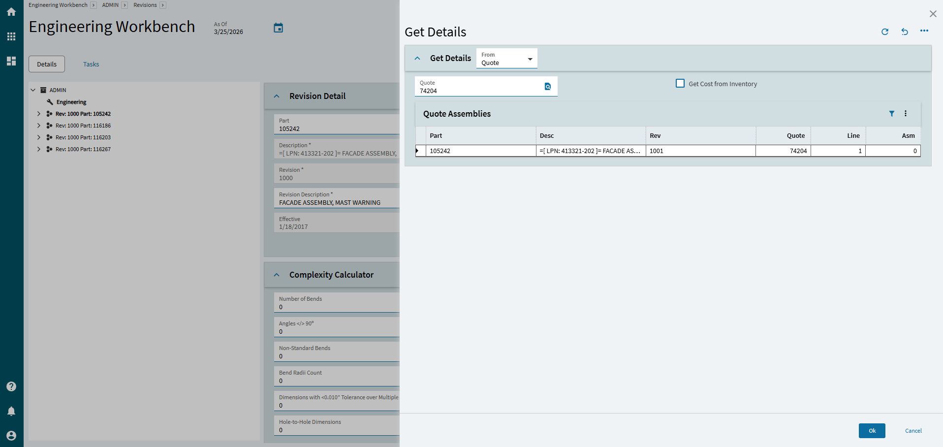

Since the 2025.2 update, GetDetails is now showing only 0-level assemblies.
This is an existential crisis for some of our processes here, so I started digging into it a little bit.

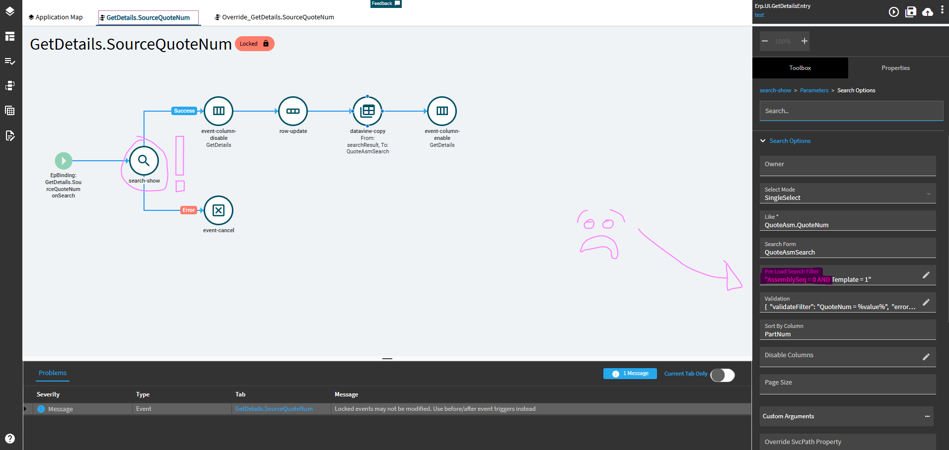

While troubleshooting, I noticed that the actual search event (GetDetails.SourceQuoteNum) which fires off when you set a QuoteNum on the form has
‘AssemblySeq = 0 AND Template = 1’ in the pre-loaded filter. Well, okay, that sure sounds like the behavior that changed.
Like anyone in way over their head would, I created a custom layer on GetDetails to start fiddling with it. I altered the preload filter and removed the AssemblySeq = 0 part.
For brevity, I’ll skip all the steps about actually hooking this up to the GetDetails process inside EngWB, but EngWB’s event was also overridden to point at the right menu/layer so that GetDetails launches with my testing layer.
I’m not sure how to attach a GFY here but the effect is that the 2nd-and-onward searches in the GD pane show all subassemblies, rather than just the 0-level. I’m not familiar enough with the search event widget to know what’s going on there and why. Selecting one of those subassemblies on the 2nd search pass, however, does correctly get mfg details from the subassembly.

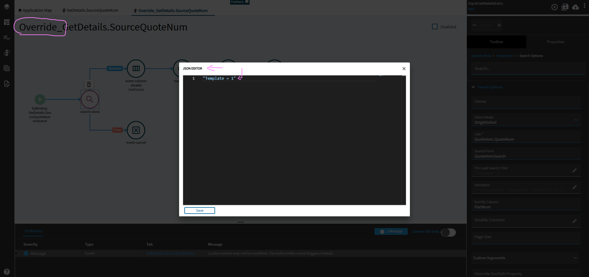

I checked how that event is laid out in 2024.2 expecting to see just the Template criteria in the filter, aaaaand:
Screenshot 2026-03-25 085623
…Wait… It’s been like this? This is the exact base GetDetails event that is running the first screenshot. Clearly this works (in 2024.2) as-is.

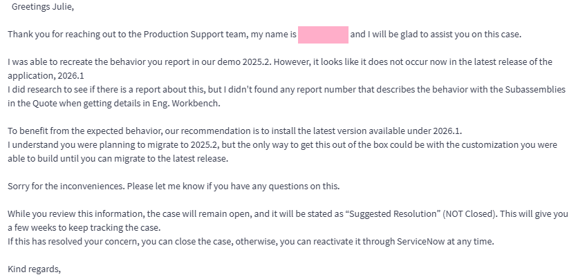

Well, I got a comment on my ticket. My support-rep’s name has been removed, this isn’t really their fault.
This bug is confirmed and replicable.
The suggestion?
Upgrade to 2026.1; Otherwise, deploy the customization I created.
