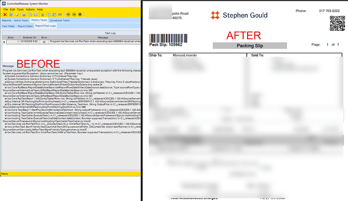

I chased this down this morning with a debugger, the issue is that the new Packing Slip report IF a Phantom is present assumes there is a “Data Source” (table) in the RDD called “CartonTrkDtl”

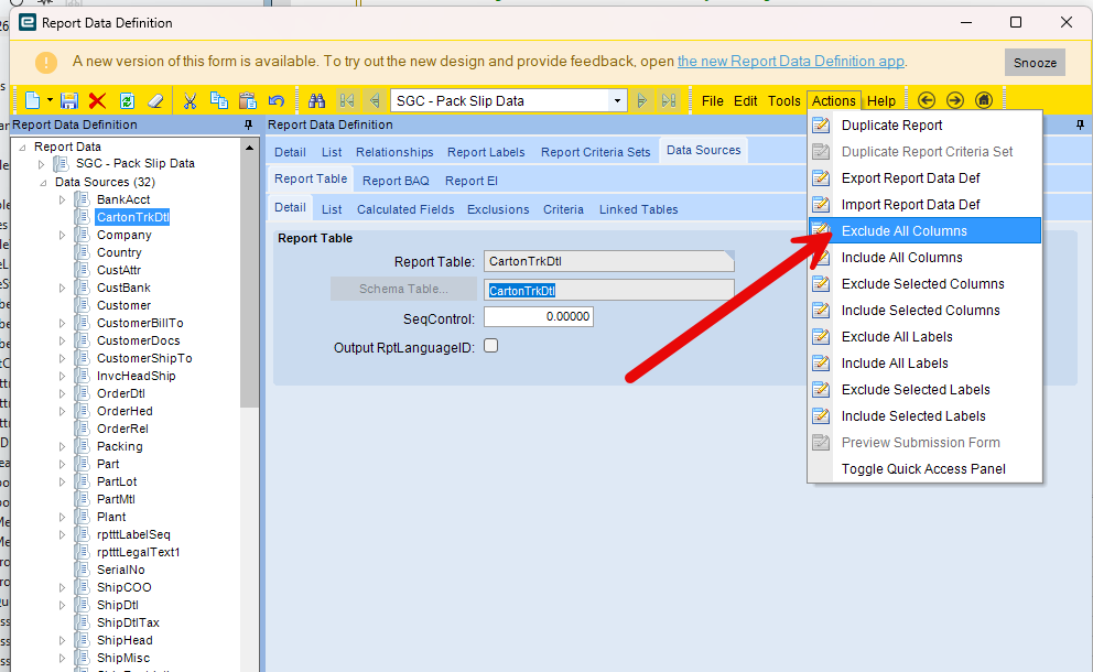

The fix is pretty easy, open the ofending RDD

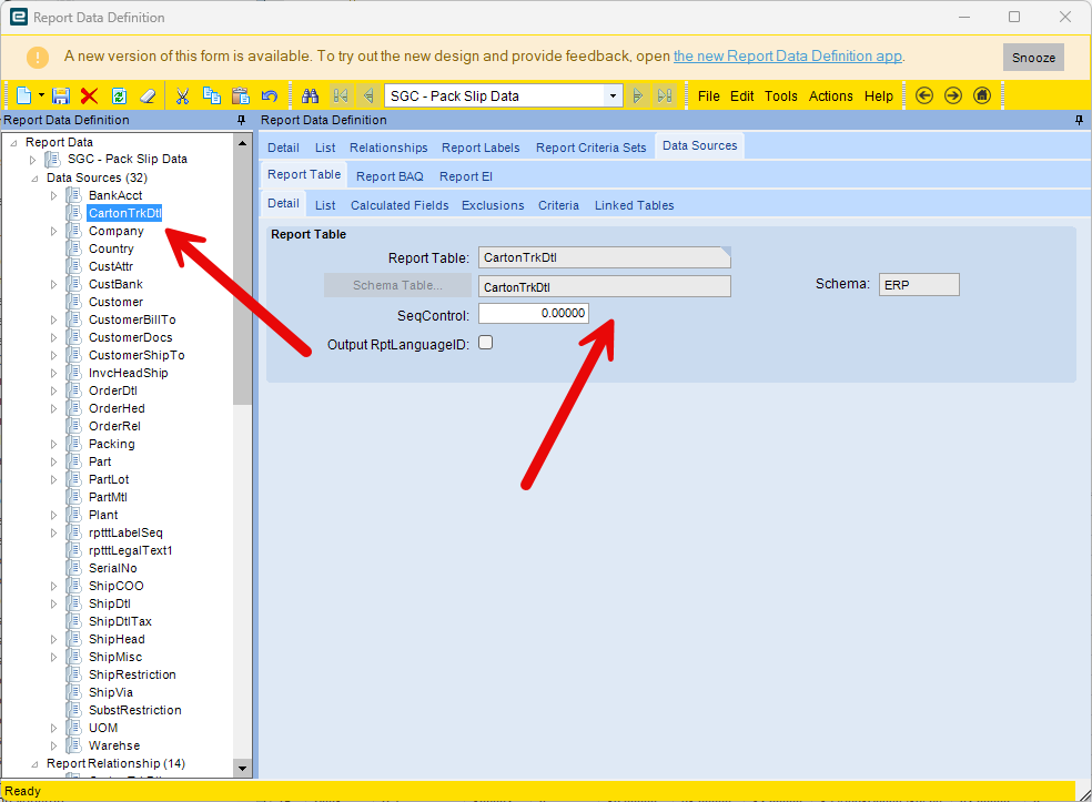

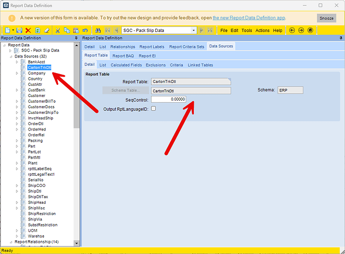

New → Table
ReportTable: CartonTrkDtl
Schema Name: CartonTrkDtl Echema: ERP
Save, While selected on that Table go to Actions → Exclude All Columns.

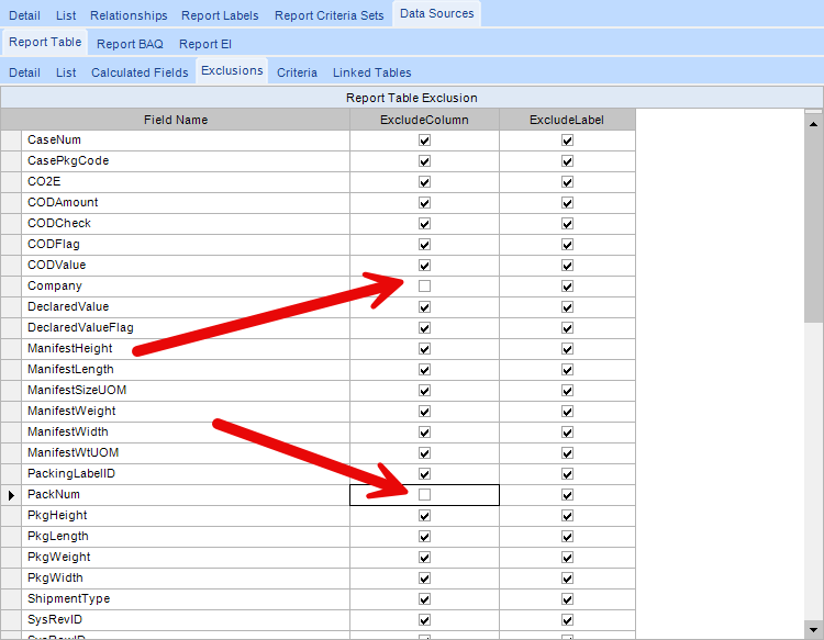

Go to Exclusions and Un-Check Company, Pack Num

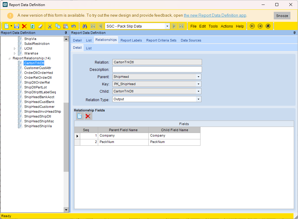

Add a Relationship Between CartonTrkDtl and ShipHead (set as output)
Save
Run the Report
