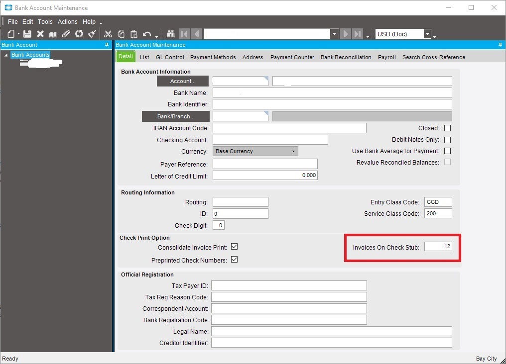

thanks it is working i just have a concern what will happen when there is like 20 lines the lines will overlap?
You set the number of invoices you want per table in Bank Account Maintenance.
If the number of invoices exceeds this, it will automatically void the next check number and continue the detail on the following check.
