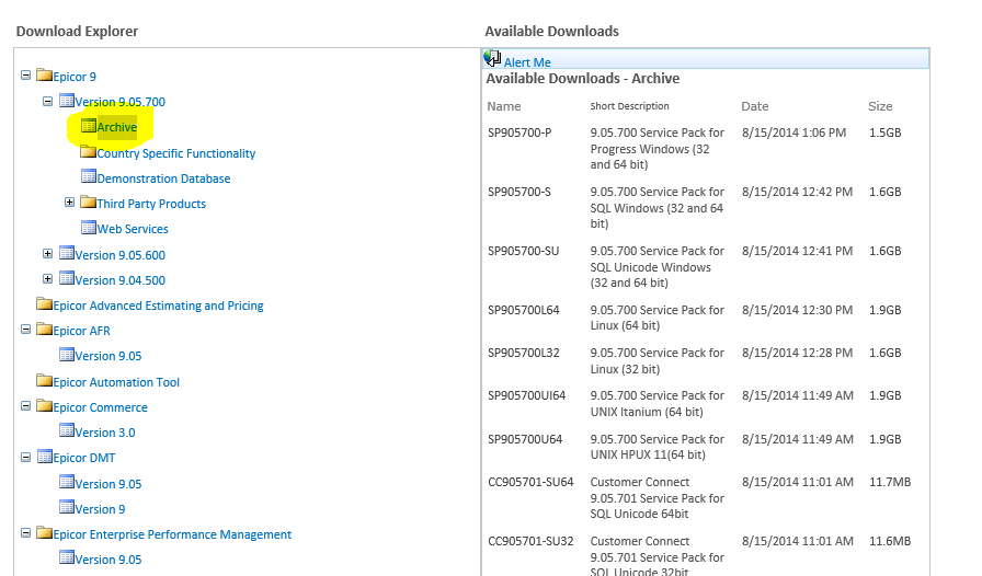

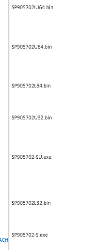

The only files beginning with “SP” under the 9.05.700 download explorer are “SP905702” files(see attached pictures). I need to go from 9.05.604 to 9.05.700 first, and then do the patch install to 9.05.702, at least that is what the epicor upgrade guide says and why I am asking about the 9.05.700 install CD.
How about archive?

Thanks for the pointer, yes archive had the file. Now while on epicweb I noticed that there are other patches after our current version (9.05.604) such as 9.05.606, will we need to update to the .606 version before going to .700? Also once we get .700 installed, we can then just install the .702a patch correct? As it should be a cumulative update I assume?
