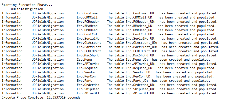

seems like there wasn’t heavy use of UD fields in E905 based on the 13 seconds of processing under the UDFieldMigration phase (13 seconds is really fast for this phase) - not bring over all of the unused but predefined UD fields from earlier versions into E10.x has been a huge benefit to DB sizes.
Yeah these folks are mostly vanilla. They have 10 BPms and like 3 customizations.
