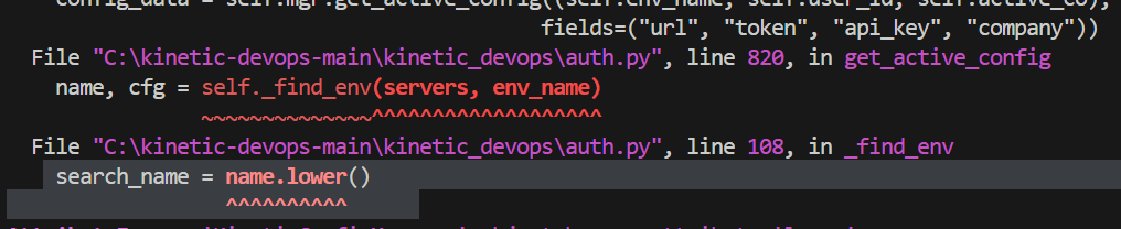

Hi Kevin,
I seem to be using python more and more and your framework looks really promising.
I’m just trying to set it up locally to understand how to work with it and when I set up the envirnment credentials, I get the following
I pasted the API key into the API (scoped) field and saved the record. I didn’t see anything to indicate that the API had pasted successfully.
When I run the script below, I get the following error.
I have updated the company name to the company I am targetting.
Please can you let me know what I have done wrong?
Thanks,
Andrew.
Error
Script

This is by design, it reduces the risk of your API appearing in logs, or captures.
have you initialized the environment:
.\scripts\env_init.ps1 Test2024 .venv
Also you can validate if your API is saved with the following:
uv run python -m kinetic_devops.auth list
Your main entry point from development is going to be the base client, otherwise you’re reinventing the wheel.
from .base_client import KineticBaseClient
Best analogy is that KineticBaseClient is the little black box I’ve built and shared with the community. It’s intended to handle all the communication and authentication so other functions etc. don’t have to.
