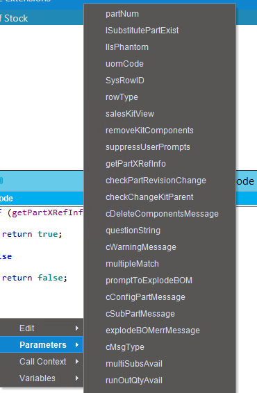

<parameter name="ds" type="Erp.BO.SalesOrderDataSet">
Id like to check the value of these. You can access param values in a BPM easily:
