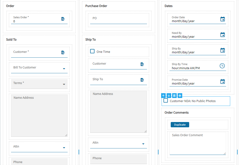

  • I have created a NDA checkbox in Customer and it was saving it on Customer table. Now how can reflect the value of it to Sales order when I select the customer.

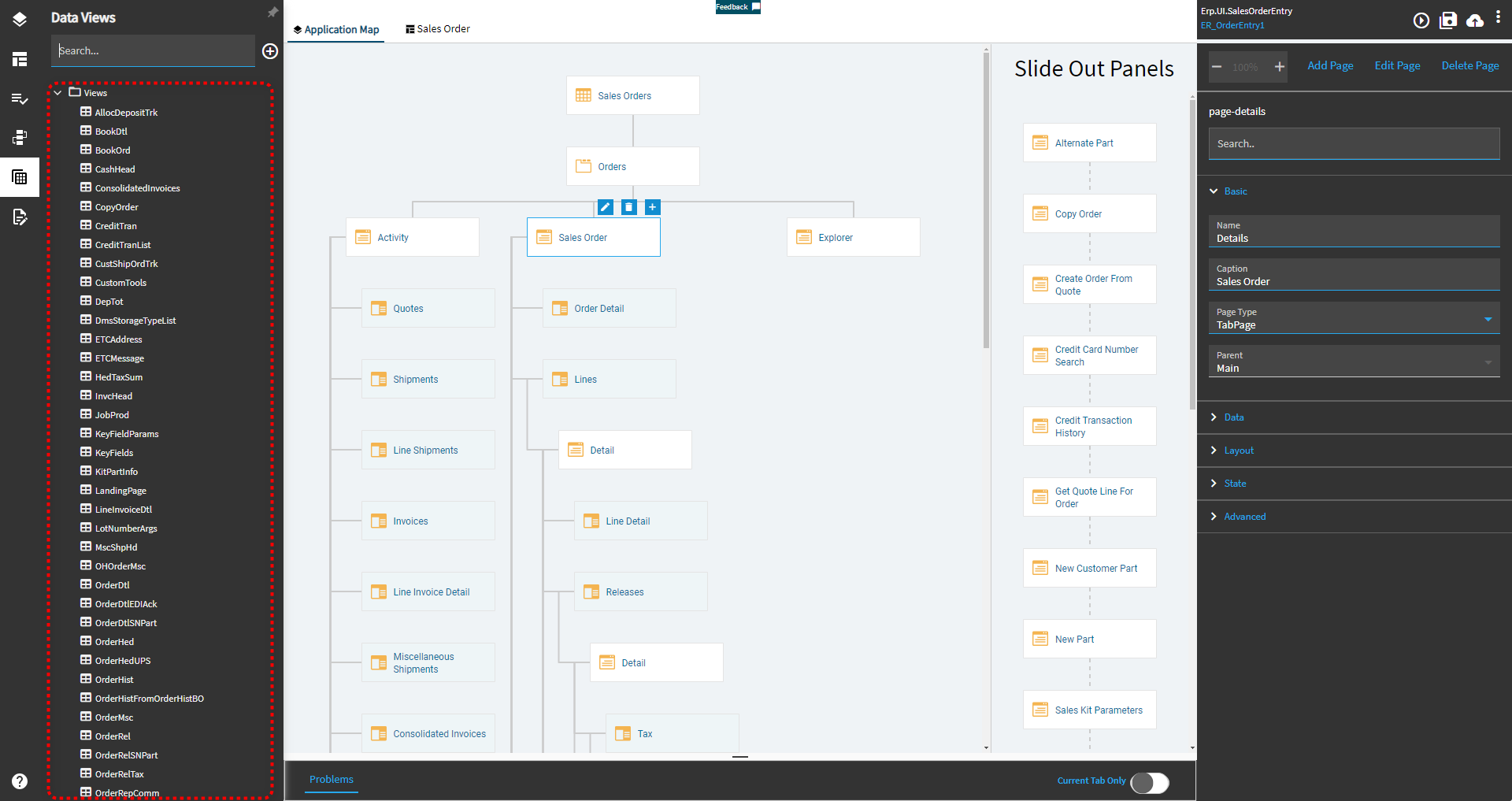

My approach to this would be to add a Customer dataview to Order Entry.

Do I have to add it via this way?

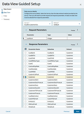

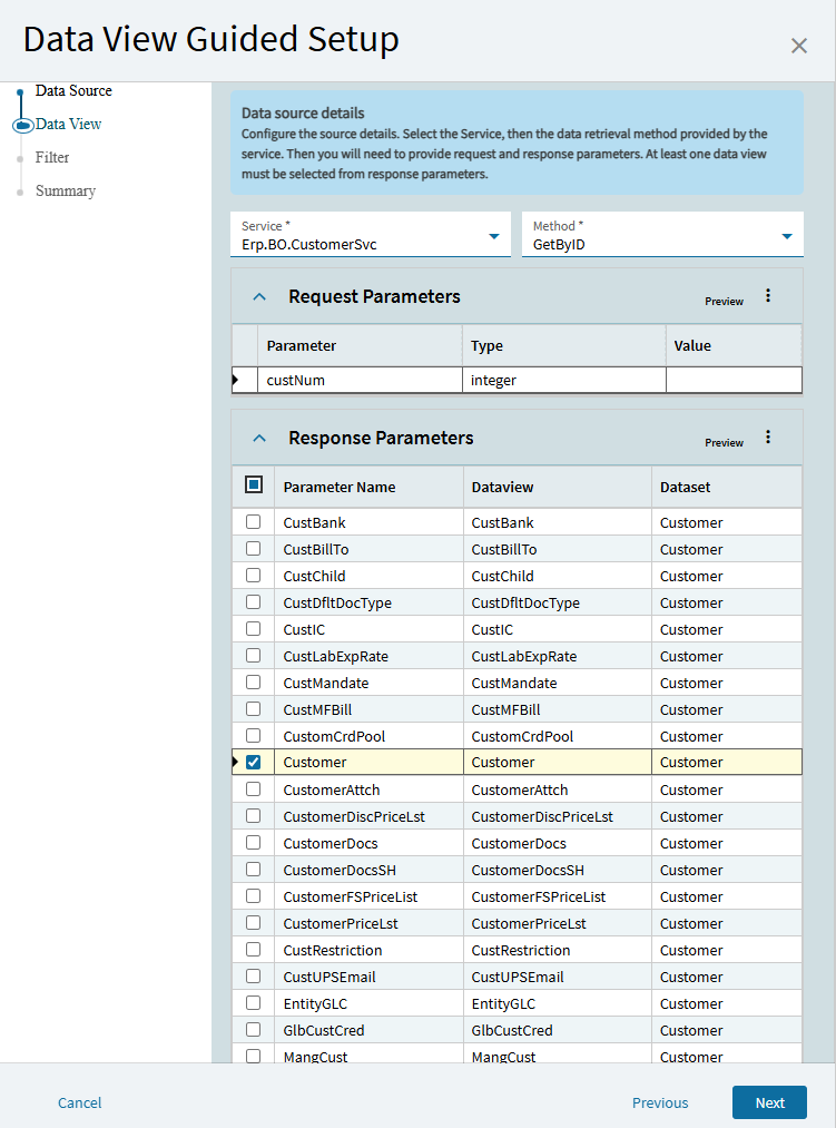

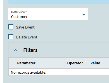

Yes. Click the New (+) icon there and use the Data View Guided Setup wizard.
Source Type: BO Service Call > Next
Service: Erp.BO.CustomerSvc
Method: GetByID
You’ll then have to select one (or many) response parameters. The only one you’ll need is “Customer”. Select that and click Next
It’ll provide a Data View called Customer in the next screen (drop down). You don’t need to create a “save” or “delete” event. So, don’t click those options.

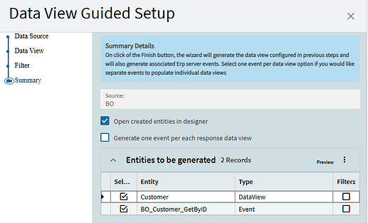

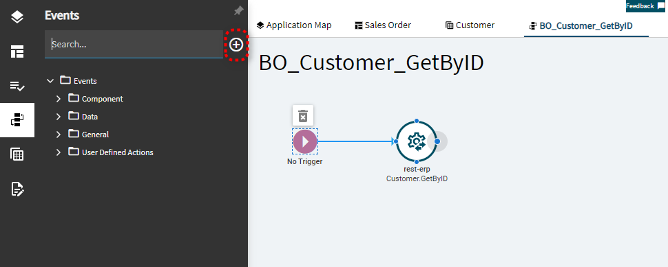

You should see this screen. It is going to create the Customer DataView and a “GetByID” event for you.

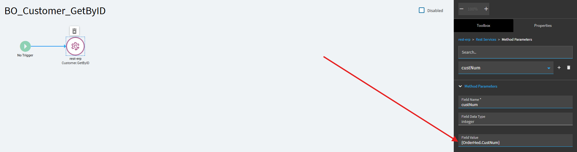

In the event it creates for you, you’ll want to go into the properties: Advanced > Rest Services > Method Parameters
Add {OrderHed.CustNum} to the Field Value. This is the value we’re going to send with our rest call.
That should be the only thing you need to set. The wizard should have already filled in the response parameters.
Leave the trigger on this event blank. We actually need to call this in a couple different scenarios… so just leave it with no trigger.

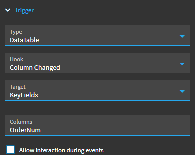

Trigger:

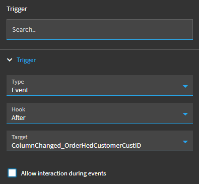

and (2)… you need this event to fire when someone enters or changes the customer on the Sales Order (for new orders or changes to that field).

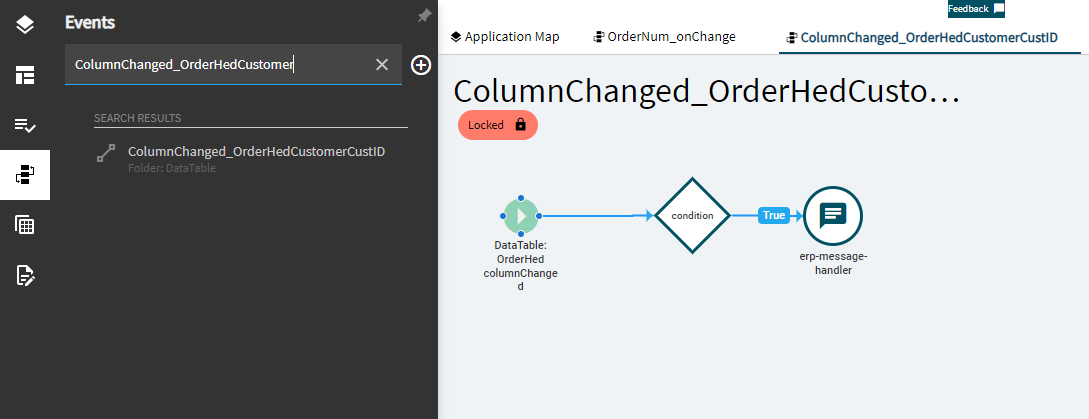

In this case there is already some events that fire when you change customers on the Sales Order… so we’re going to pin our event to fire AFTER they do.
Trigger:
If you have a field on your form mapped to Customer.YOURFIELD… it should get updated whenever these fire.

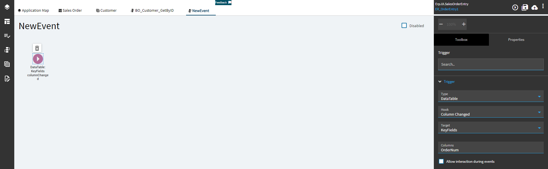

Hi David, when creating new event do I need to do it here?
Hi David, how can I link it to the BO_Customer_GetByID
where do i find that?

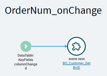

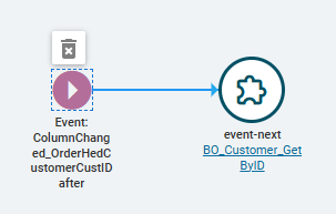

To call another event within your event, go into the tool box and search for event-next.
click and drag that onto your canvas.
Then you can click into the properties of that event next and you’ll have to type in the name of the event you want to call. In this case: BO_Customer_GetByID

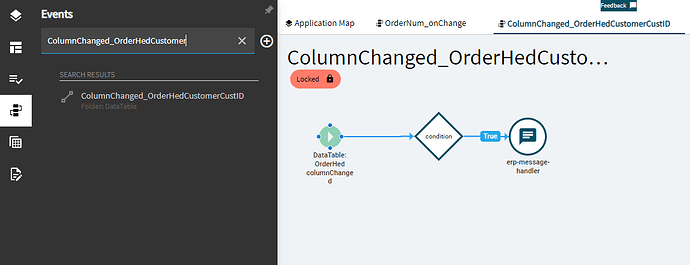

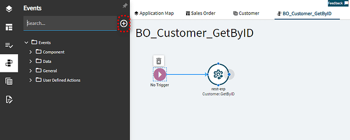

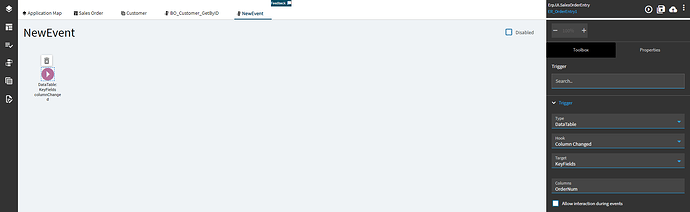

David, For Option 2 is it this one?
Do I need to create a new Event?
Yes, you would create a NEW event… and the trigger would be set so it fires after the one you have pictured.
I can name it anything right? Thanks again.
yup. name it whatever you want.

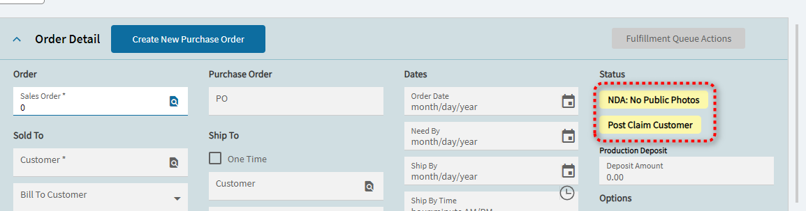

It worked! now when I do that and cancel the transaction how to clear it?
What do you mean by cancelling the transaction? Just want to make sure I understand.
I created a new order then selected the Customer and it show it works. But after cancelling the order the value still stays and won’t clear
