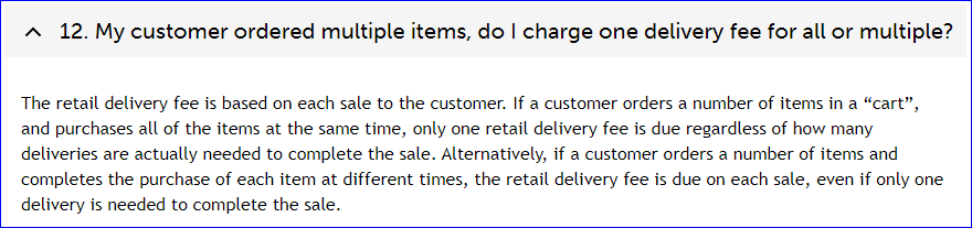

Our read is that the fee only gets charged once per order, regardless of how many shipments are delivered in CO. So a single order with 10 different delivery locations in CO â $.27. A single order with 1 shipment to CO and 9 to other locations in the country â $.27.
The answer to FAQ #12 certainly clarifies how the CRDF should be applied for orders. IMO, it also reveals the faulty logic between the presumed intent of the statute and the application of it!

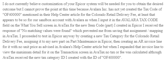

Epicor development and I both successfully tested this with both sales orders and with AR invoices dated in July 2022 after you and I exchanged email replies for your support case earlier today. Our tests involved creating the Tax Category ID of OF400000 in Epicorâs Product Tax Category Maintenance screen, assigning that new Tax Category to the new test part on Part Maintenance with NO Avalara System Tax Code assignment / mapping done on the âWhat You Sellâ screen in AvaTax for that new test part

IMPORTANT NOTE: On 6/10/2022 I called Avalara Technical Support which confirmed Avalara personnel have not yet created the Avalara System Tax Code of âOF400000â mentioned in their Avalara Help Center article for the subject of âACTION NEEDED: Colorado Retail Delivery Fee begins July 1, 2022â. The Avalara support rep. I spoke with said they do not currently have an ETA for when they will create that tax code but he said it will be created before 7/1/2022 which is when the new Colorado Retail Delivery Fee takes effect.
NOTE: As of 6/22/2022 I still could not assign the Avalara Tax Code of âOF400000â mentioned in Avalaraâs Help Center article to my new CO RET DEL FEE part number (Item Code in Avalara terminology) on the What You Sell screen in AvaTax as I received the response of âNo matching values were foundâ when inputting it in the AVALARA TAX CODE field there. However, Epicor Development and Epicor Technical Support both successfully tested the other method on 6/21/2022 which is to create the Tax Category ID of OF400000 in Epicorâs Product Tax Category Maintenance screen, assign that new Tax Category to the new test part on Part Maintenance in Epicor with NO Avalara System Tax Code assignment / mapping done on the âWhat You Sellâ screen in AvaTax for that new test part.
