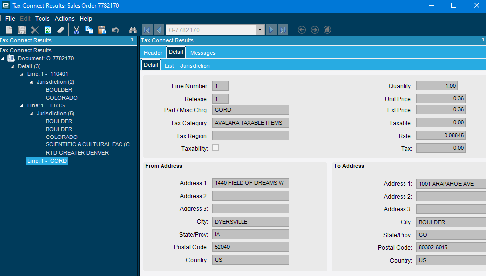

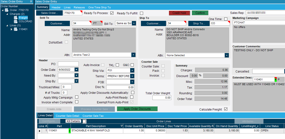

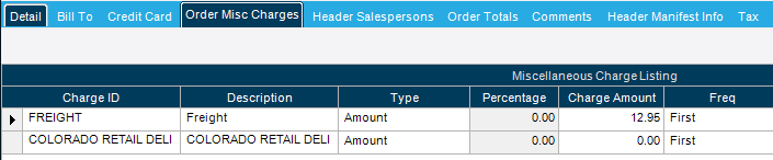

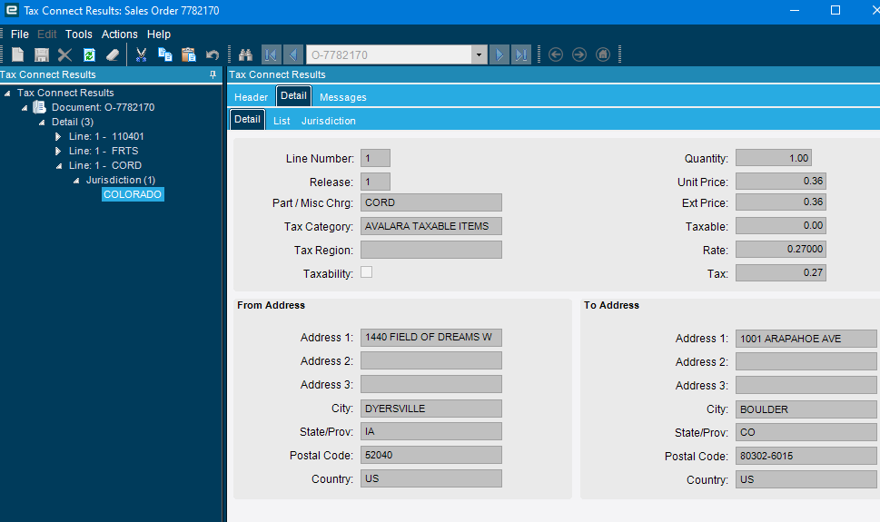

@Jonathan - Misc Header Charge amount was $0, and I left the ShipBy date blank. I thought that Avalara would add this to the tax when the CORD line was on the order.
Order date is June 30, it wonât calculate the fee unless its July 1st or later.
@Jonathan - Thank you! I didnât realize Avalara used the Order Date field for the tax calcs. I changed it to 7/1, and it worked. Getting there!

#10. If itâs a misc header charge with a frequency of âFIRSTâ, itâll get charged and invoiced once, no matter what. It doesnât get refunded if the order was shipped. If it was cancelled and not shipped, AR would refund the order in full. If it hasnât been shipped/invoiced yet, prepayments should be deposits, without sales actual tax liability. Iâll need to test, or just worry about this the first time it happens (yay! another EpiCare case!)
#11 & 13. I havenât tested shipments, but donât see why it would matter. Itâs just a header charge thatâs set to invoice on the first invoice. Another reason not to do a full part line that needs to be âshippedâ.

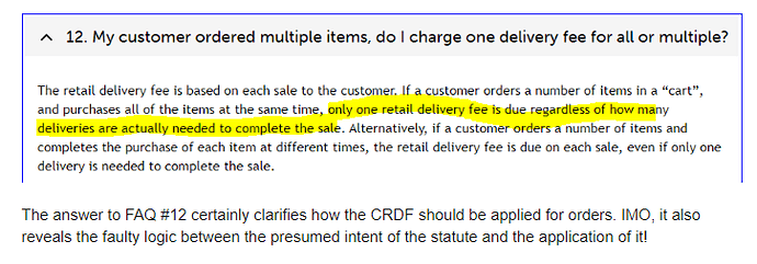

#18. The Colorado law says âOrderâ so Iâd take it on their word. Releases = more shipments on the same order, so no, it only applies once. They only get $.27 once, those greedy (&(^&%@##'s.

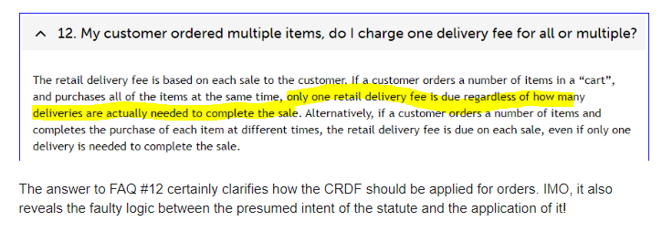

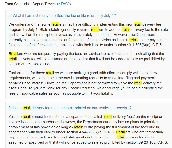

From Coloradoâs Dept of Revenue FAQâs
6. What if I am not ready to collect the fee or file returns by July 1?
We understand that some retailers may have difficulty implementing this new retail delivery fee program by July 1. State statute generally requires retailers to add the retail delivery fee to the sale and show it on the receipt or invoice as a separately stated item. However, the Department currently has no plans to prioritize enforcement of this provision as long as retailers are paying the full amount of the fees due in accordance with their liability under section 43-4-605(6)(c), C.R.S.
Retailers who are temporarily paying the fees are advised to avoid statements indicating that the retail delivery fee will be assumed or absorbed or that it will not be added to sale as prohibited by section 39-26-108, C.R.S.
Furthermore, for those retailers who are making a good-faith effort to comply with these new requirements, we plan to be generous in granting requests to waive late filing and payment penalties and interest. However, the Department is not permitted to waive the retail delivery fee itself. Because you are liable for any uncollected fees, we encourage you to begin collecting the fees on applicable sales as soon as possible to limit your liability.
8. Is the retail delivery fee required to be printed on our invoices or receipts?
Yes, the retailer must list the fee as a separate item called âretail delivery feesâ on the receipt or invoice issued to the purchaser. However, the Department currently has no plans to prioritize enforcement of this provision as long as retailers are paying the full amount of the fees due in accordance with their liability under section 43-4-605(6)(c), C.R.S. Retailers who are temporarily paying the fees are advised to avoid statements indicating that the retail delivery fee will be assumed or absorbed or that it will not be added to sale as prohibited by section 39-26-108, C.R.S.
