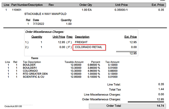

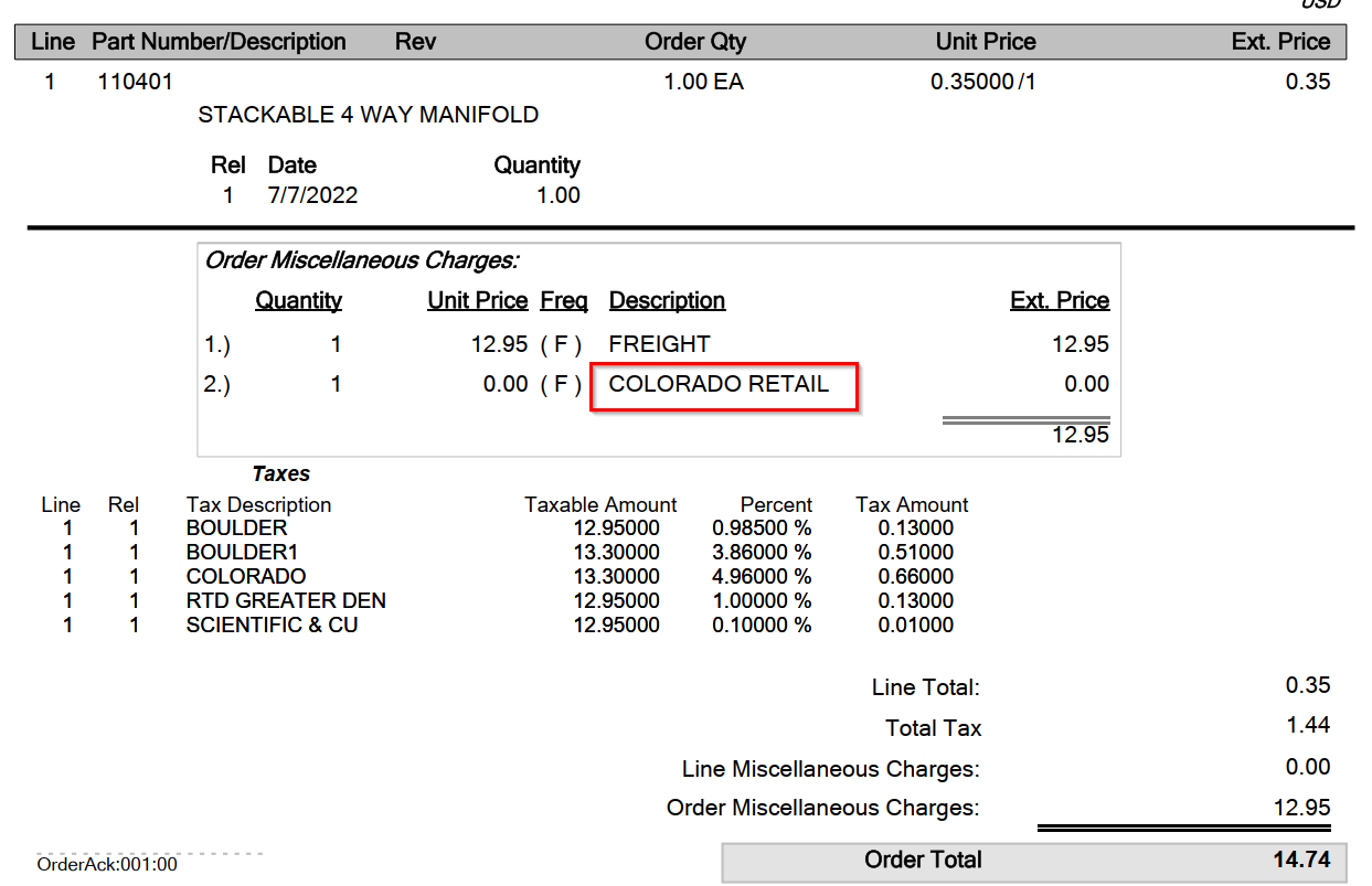

@aosemwengie1 - Does it matter if it’s a part (Line>0) or misc header charge (Line 0)? Both the SO Ack and Invoice show the CORD miscellaneous charge, which should be $0 per the KB article, so the $.27 would need to be shown in part/misc description or broken out another way.
The $.27 gets aggregated in the Total Tax amount from Avalara… We’ll change the CORD description to show ‘CO RtlDelivFee, $.27 Incl In Tax’ or whatever will fit in the character limit we get. I’m not sure how much time we want to spend getting fancy with SSRS to catch that separate $.27 from Avalara and break out the tax line.

Right - but does it get listed separately?

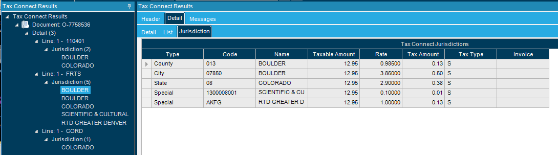

Sort-of. The std ssrs report shows misc charges separately and displays the misc charge description. That can be edited within the to show the $.27, but we’re limited to 30 characters… Use something like ‘CO RTL DLV FEE $.27 APPLIED’ and adjust your SSRS Report to not clip the description.
Also, it seems the SOAck’s Std SSRS tax breakdown doesn’t match the Avalara Tax Connect Results, but the total amount does. AvaTax is burying the $.27 in there somewhere…
SOAck Std SSRS:

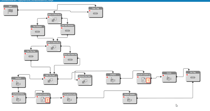

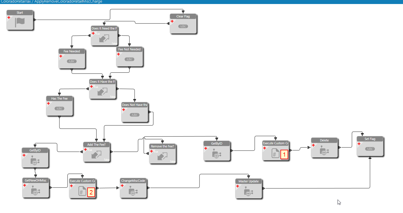

Attached is a function that takes an OrderNumber and either adds or removes the MISC CHARGE “CORD” if needed.
It is mostly no code though there are some minor things that I couldn’t do without code. My version is 2021.2.10 so anyone on or above that should be able to use it.
Assumptions:
Assumes there is a valid Misc Code in the system called “CORD”
EFX: ColoradoRetailTax.efxb (738.4 KB)
Input: OrderNum
Output: ChargeAddedRemoved (boolean) returns True if it made a change to the order
Flow:
Checks if the Fee is Needed by Looking at (ShipTo.State=“CO” OR OTS.State="CO) and DocTotalTax > 0
If the above is true it determines if the order already has the charge by looking for an existing OHMiscHed charge MiscCode=“CORD”
IF Needed and Doesn’t have it (Adds it)
IF Not Needed and Has it (Removes it)
The two bits of custom code are because Epicor still hasnt’ provided an easy way to to set RowMod using widgets particularly for new rows.
//1
ods.OHOrderMsc.Where(r=>r.MiscCode=="CORD").FirstOrDefault().SetRowState(IceRowState.Deleted); //Sets the "CORD" to Deleted State so its removed with the Update
//2
ods.OHOrderMsc.Where(r=>r.Added()).FirstOrDefault().MiscCode="CORD";
//Sets the Misc Code of the Newly added Row
I did some minimum testing on this so if you find any issues let me know.
I offer no guarantees, test this stuff in your system thoroughly before you just put it in production. Seriously if it breaks and deletes all your orders don’t call me.

Thank you Jose! I was able to import it into my 2021.2.8 environment, and start kicking the tires. Curious - Why start by setting the ‘ChargeAddRemoved’ argument to false, and finish the flow by setting it to true? I didn’t see it referenced inside any of the other widgets.
It only gets set to true if you get through adding or deleting something otherwise it never gets to the end it exits / aborts on some of the conditions
So it’s only true if something was added / deleted
