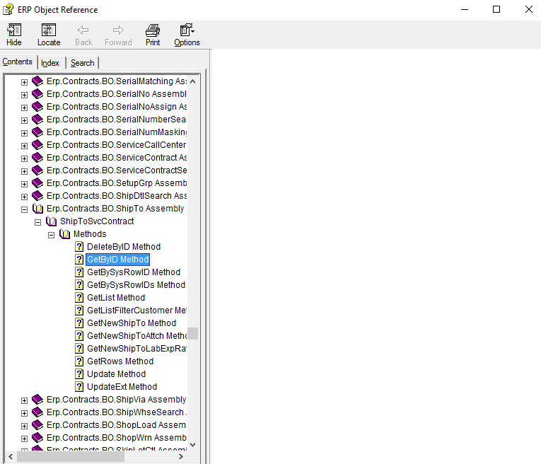

Sorry for the necro, but is the suggestion to get the BO reference download still valid? I tried it for 10.200x and my screen comes up blank:
Randy, right-click the file and go to Properties -> General. There is likely something about it being blocked – click ā€œUnblockā€ to get full access.
Unblock_File
That was it! Thanks @bacoombs

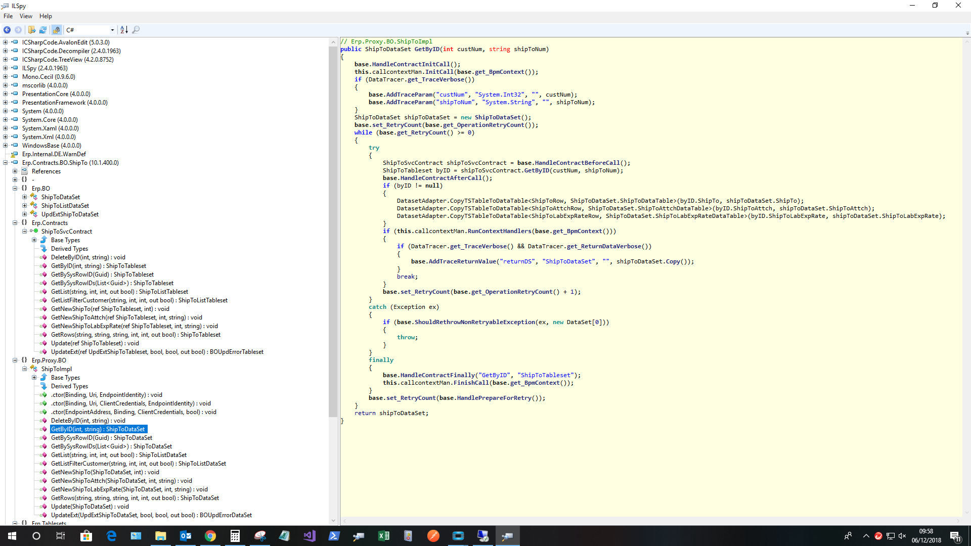

@Randy
decompiling the file will give you the actual C# script code
