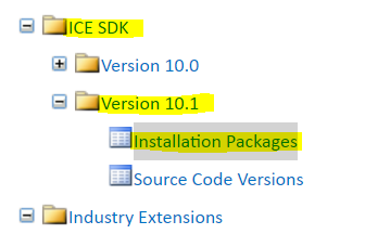

The Epicor SDK documentation provides answers to your specific questions. You can find them in Epicorweb, under downloads of Epicor 10.1.x > SDK.
Link:
https://epicweb.epicor.com/products/epicor-erp-10/downloads
and then here:
  1. SDK_ObjectGuide_101600.pdf
  2. SDK_UserInterface_101600.pdf

I just went there and I could not see any documentation. Is there documentation there that others can see?
I don’t see any SDK documents either. I suspect that they are only
available/visible if you have purchased the SDK from Epicor.

Good point. We have not purchased the SDK.
This is the gap we are discussing internally. The SDK is targeted for folks building new silos or products upon the ICE framework just as ERP does. For customizing, the tools in the box are provided. But what’s in between? That integration scenario from external systems into ERP are covered by Service Connect but that’s not always an exact fit. SC is more of a BtoB integration system along the lines of BizTalk with excellent flexibility and good governance tracking abilities but not really suited for pointing a web page at the BOs.
