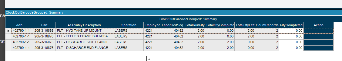

I was able to add this code and it gets me some buttons
		workGrid.DisplayLayout.Bands[0].Columns.Add("CompleteQty","Action");
		workGrid.DisplayLayout.Bands[0].Columns["CompleteQty"].Style = Infragistics.Win.UltraWinGrid.ColumnStyle.Button;
		workGrid.DisplayLayout.Bands[0].Columns["CompleteQty"].ButtonDisplayStyle = Infragistics.Win.UltraWinGrid.ButtonDisplayStyle.Always;
Now I just have to figure out how to get the event wired up. Looks like I need to use ClickCellButton event according to this page.

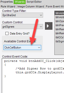

as for adding the event handlers?
You could just hand type them into the initialize and destroy methods, just copy what you see for a wizard added section but mod it to fir your new button
looks like there is a built in wizard for the handler
and once you have an event handler built in you just do your code action off of that method
    private void yourGrid_ClickCellButton(object sender, CellEventArgs e)
        if (e.Cell.Column.Key == "YourButton")
            //do someting
thanks. Looks like I have to make a grid to get to that. It’s annoying that the wizard won’t connected to existing controls.
Is there a way to get a list of available arguments to use on an event handler? I’ve got it working to where I can click the button and get the message to pop up, but I need to get information from the row being clicked on. I’m trying to find some info in the object explorer but am having a tough time.
	private void workGrid_ClickCellButton(object sender, Infragistics.Win.UltraWinGrid.CellEventArgs args)
		MessageBox.Show("Cell Clicked");
that shows me one, which is the text in the cell. Is that the only thing I can get with it?
        //do someting
well it looks like you’ll be able to access properties of the cell (in this case “e”) like in this example
So I couldn’t figure out how to get anything else from the properties other than the key or the cell text (which there is none in this case) so I just ended up putting a foreach loop in there. It’s probably not the best way to do it, but that’s all I could figure out for now. If anyone has any better suggestions, let me know.
