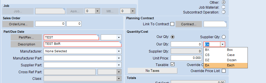

Is there a way to add on to the 4 UOM that are in the Purchase Order Entry Line menu? Right now we only have Case, Box, Dozen, and Each appearing, but we have more than a dozen within the UOM table including the one we need (Lbs.).
I understand this field may also be on the part entry menu but can i go into developer mode and add onto the combo box and it will appear? Or is there a better way to modify this?
Can you show some screen shots of what you are seeing? I’m thinking it has to be a setup issue, but I’m not 100% sure where you are talking about.
The drop down on the far right is what im having the issue with. these are the same options as the part master:

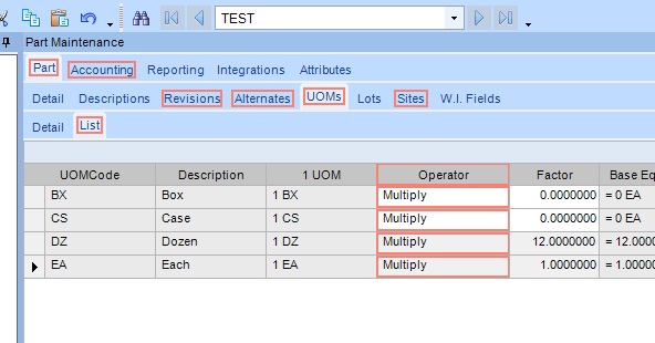

As you can see we have the Lbs. uom in the system:

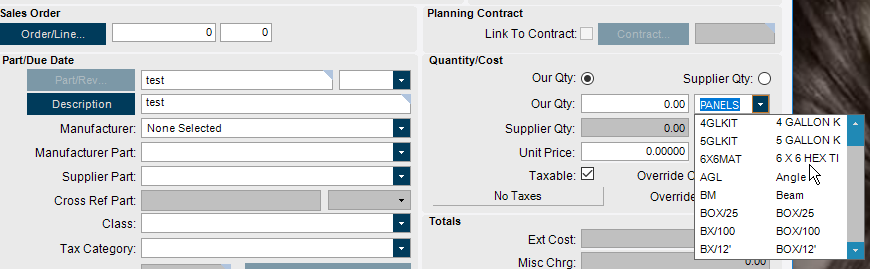

That’s odd. All of mine show up… If this form by any chance customized?

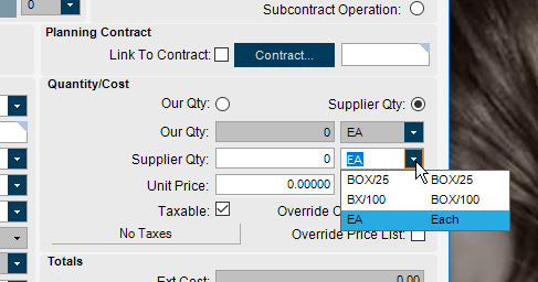

On the supplier side, it seems to limit the UOM’s to what I have selected in our quantity. But that’s not the same as what you are seeing. It looks similar though.
Maybe a dumb question but are they all Active (both class and UOM)? The drop-down population search criteria is this on a type other.
<parameter name="whereClause" type="System.String"><![CDATA[((Active=True) AND (StockOnly = true))]]></parameter>
with mine, both active and inactive show up. (which is actually really annoying)

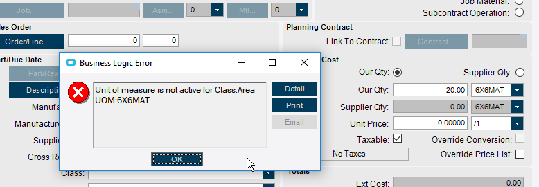

It comes up with this when you try to save though.
Odd - they really should not be appearing in the drop-down. It functions that way in my testing but there could be a scenario that allows them to appear.

The part is a real part, they’re test bars, and they are kept in stock within the system. When i navigate to the UOM tab on Part Entry only the 4 UOMs mentioned before in this thread appear. I see what you mean about the COUNT and WEIGHT options but can i just remove Lbs from WEIGHT and add it on to Count? We rarely use the UOM field in Epicor, outside of purchasing, so i cant imagine this screwing anyone else up.

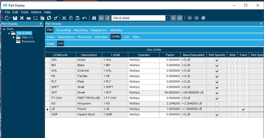

Thank you both for the detailed explanations. So i now clearly see that the UOM class is locked on the parts as you’ve said. One of our other materials, metal, has the correct UOM class and allows me to select Lbs. This was something that was never pointed out to me in the past so now i need to do some cleaning up.
