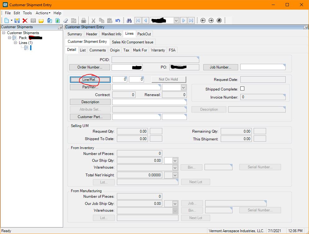

I am looking at the Customer Shipment Entry form. When I create a new pack, choose an order, then add a line to the pack, I have to click on the “Line/Rel” search box in the Lines tab. This brings up a search box to allow the user to choose a line/release for the pack. We need to see an additional field in this list: OrderDtl.CustomerXRev. I would prefer to just add this field right to the base search. But it doesn’t seem possible. It looks like the BO is “OrderRelSearch”.

  1. The “OrderRelSearch” takes in a where clause that include the order number. How can I pass that order number from the Customer Shipment Entry to the BAQ?
  2. The “OrderRelSearrch” returns two fields to Customer Shipment Entry. The Order Line, and the Order Release. How can I make my BAQ return those values to the Customer Shipment Entry form?
I would prefer not to customize the form, and just work on a better search.
