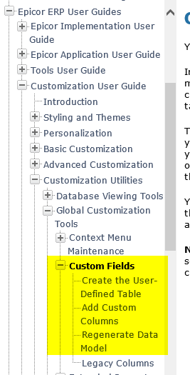

It is well documented in the On Line help
Search for " Create the User-Defined Table" then back up one level
Search the help for
- “Developing a Modified Version of an Epicor Shipped SSRS Report”
for a good step-by-step example of adding a UD field to a table, and then adding that field to an Epicor supplied report
