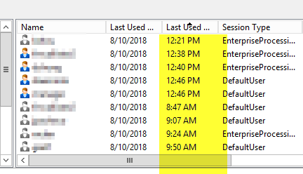

While theyâre updating the Admin Console, can you have the sorts for date and time columns actually be by date(or time) and not the string displayed.
