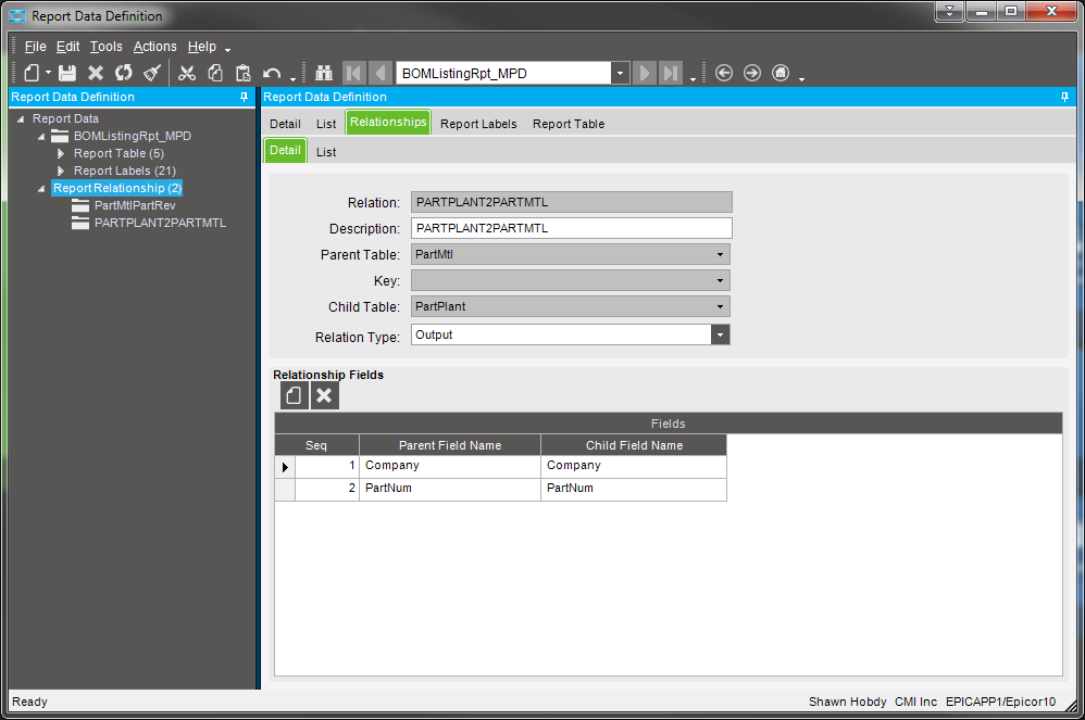

I added PartPlant table in RDD and made sure relevant fields were not excluded.
Created relationship to PartMtl:

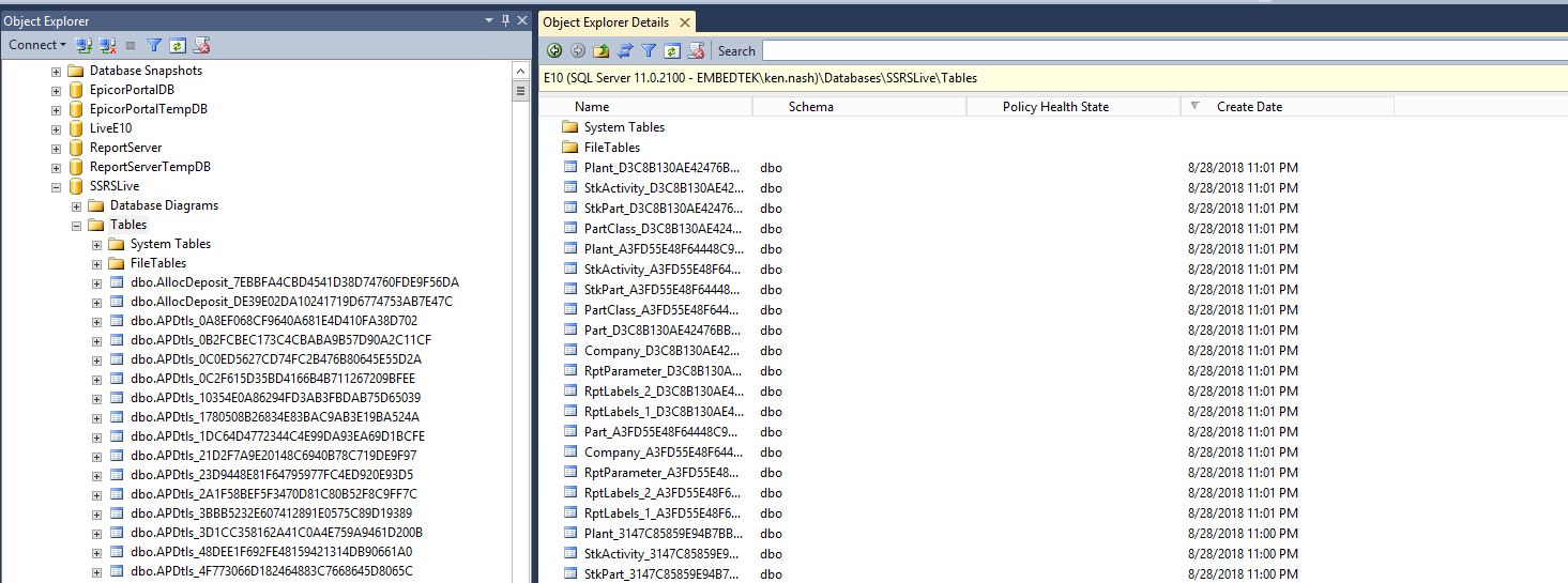

Do you have access to a sql editor? When you create a report a temp table is created, which your report then calls.
ie PartPlant_" + Parameters!TableGuid.Value + "
Are you able to see those tables to confirm the field is there with the expected data?

Run the report archive for a day, this keeps the table there.
In Studio
Open the SSRS database find the table you are using in your report.
Sort the tables to find out the correct on with the GUID. Then do a basic query to select * from the table.

Thank you for that tip! It showed me that I was only pulling in 1 row of data. I have to change the relationship fields it connected with from PartNum = PartNum to MtlPartNum = PartNum.
It then pulled in all the data I needed.

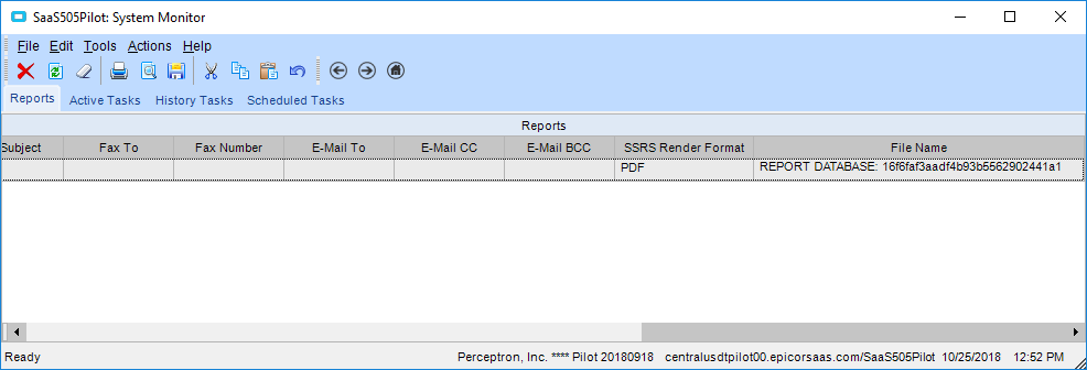

You can also get the report GUID from the System Monitor. Do like Ken said, run the report with 1 day archive then go to the Reports tab and scroll all the way to the right. This tip is for those of you who can’t/won’t use SSMS.
Mark W.
I knew where to get the GUID in the monitor, just wasn’t sure where to find the temp tables and their info. Good to know that they are on the SSRS SQL server.
