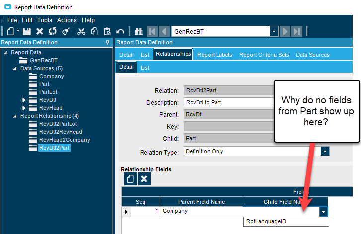

I’m trying to add the part table to a report data definition. I don’t know what I’m doing wrong. Trying to add Part table to RcvDtl.
I try to make a relationship and no fields from the Part Table are pulled in.

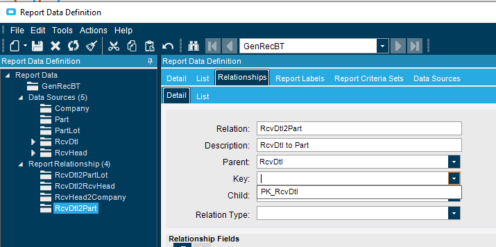

Also the only thing in the “Key” field is which I don’t understand.
Also what’s the difference betwen Definition Only and Output in relation type? This entire screen is a big head scratcher.
You have to go to the exclusions tab for the part table and uncheck the boxes for the fields to include. Its actually worse than that, if you just added the table, you have to first refresh to get the exclusions tab to populate.

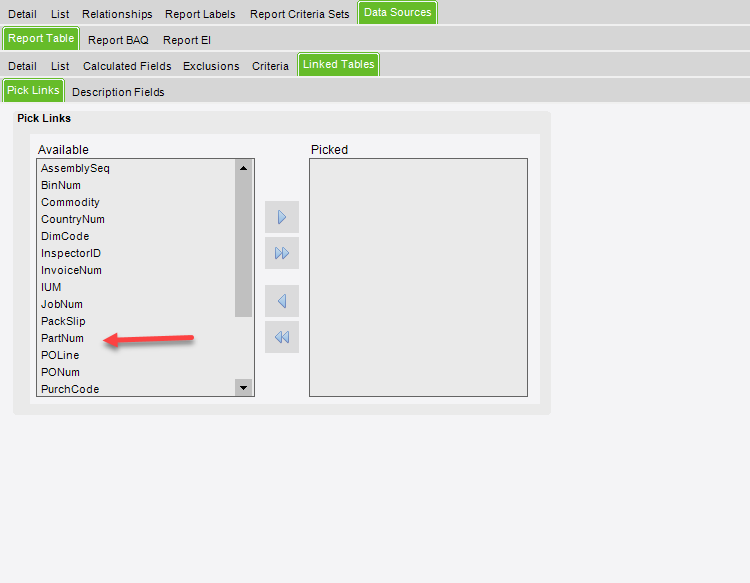

Click on the RcvDtl in the tree and go to Data Sources\Report Table\Linked Tables\Pick Links. Select PartNum and move it to the Picked box.

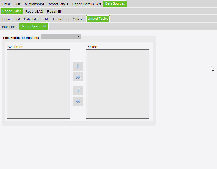

Now go to Description Fields tab and look for your field under Available and move to Picked. Nothing is showing in my screenshot because I am in the system RDD.
