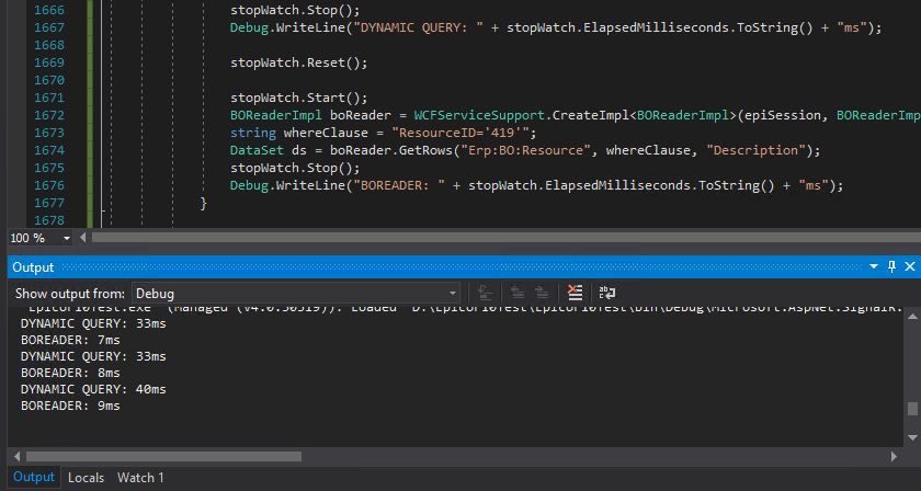

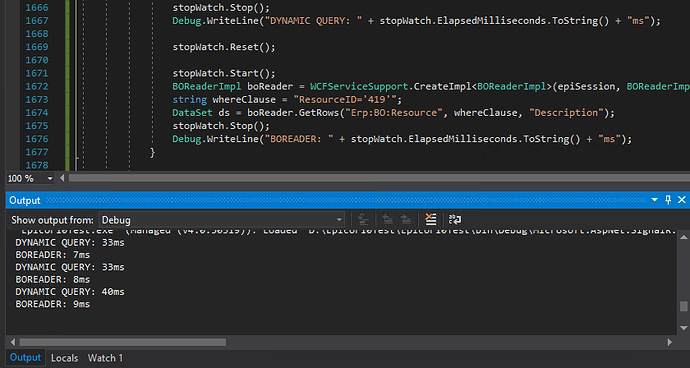

you are using GetList, would GetRows to grid could make a different ?
Good call, let me try that
Still similar results
then based on this, the second step which is inserting back the data to existed grid row by row is the bottleneck as DQ will display the whole data in one hit !! am i right ?
Yes, I think it is slow because it runs for each row in the grid. I have done in the past if I know I need data like this I just pull all the data in one call to a dataset (just query for Resource table on form load) then on row initialize find the relevant data in the dataset rather than running a query for each row
