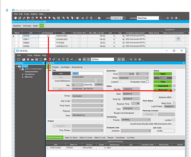

Good stuff, guys! It’s over my head right now, but I’ll be using this as an example to follow to add the JobReleased column to the Multi Resource Scheduling Board.
Here is the updated code that will work. You could probably use GetList or GetRows for this. GetList would get you some better performance.
// Custom code for ResourceSchedForm
// Created: 9/28/2018 8:47:46 AM
using System;
using System.ComponentModel;
using System.Data;
using System.Diagnostics;
using System.Windows.Forms;
using Erp.Adapters;
using Erp.UI;
using Ice.Lib;
using Ice.Adapters;
using Ice.Lib.Customization;
using Ice.Lib.ExtendedProps;
using Ice.Lib.Framework;
using Ice.Lib.Searches;
using Ice.UI.FormFunctions;
using Ice.Proxy.Lib;
using Ice.Core;
using Erp.BO;
using Ice.BO;
public class Script
	EpiUltraGrid myGrid;
	BOReaderImpl _boReader;
		myGrid = (EpiUltraGrid)csm.GetNativeControlReference("87f88dc8-1b94-4324-ba83-583a2af5cbb9");
		myGrid.DisplayLayout.Bands[0].Columns.Add("JobReleased","Job Released");
		myGrid.InitializeRow += new Infragistics.Win.UltraWinGrid.InitializeRowEventHandler(grdMatLst_InitializeRow);
		_boReader = WCFServiceSupport.CreateImpl<BOReaderImpl>((Ice.Core.Session)oTrans.Session, Epicor.ServiceModel.Channels.ImplBase<Ice.Contracts.BOReaderSvcContract>.UriPath);
	private void grdMatLst_InitializeRow(object sender, Infragistics.Win.UltraWinGrid.InitializeRowEventArgs e)
		if(!String.IsNullOrEmpty(e.Row.Cells["JobNum"].Value.ToString()))
			DataSet ds = _boReader.GetRows("Erp:BO:JobEntry","JobNum = '" + e.Row.Cells["JobNum"].Value.ToString() + "'","JobReleased");
			if(ds.Tables[0].Rows.Count > 0 )
				e.Row.Cells["JobReleased"].Value = ds.Tables[0].Rows[0]["JobReleased"].ToString();

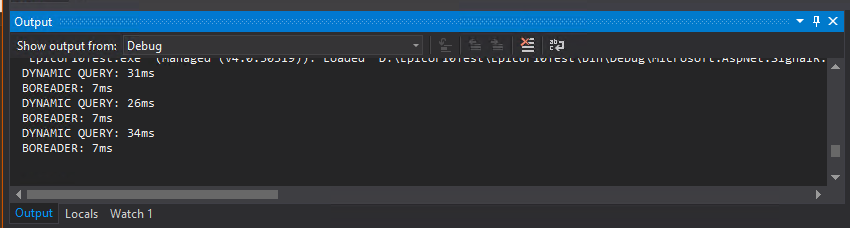

I was just indicating that in theory since you are specifying a smaller dataset to return boreader should be good to use, though I have not compared it returning the same data vs dynamic query. I have used boreader in a lot of places and haven’t observed any noticeable performance losses. I’ll run a test since I’m now curious
I am seeing BOReader is about 4-5 times faster with this test
                Stopwatch stopWatch = new Stopwatch();
                stopWatch.Start();
                DynamicQueryImpl qry = WCFServiceSupport.CreateImpl<DynamicQueryImpl>(epiSession, DynamicQueryImpl.UriPath);
                DynamicQueryDataSet qDs = qry.GetByID("boreadertest");
                QueryExecutionDataSet qed = new QueryExecutionDataSet();
                qDs.QueryWhereItem[0].RValue = "419";
                qDs.AcceptChanges();
                var baqRes = qry.Execute(qDs, qed);
                stopWatch.Stop();
                Debug.WriteLine("DYNAMIC QUERY: " + stopWatch.ElapsedMilliseconds.ToString() + "ms");
                stopWatch.Reset();
                stopWatch.Start();
                BOReaderImpl boReader = WCFServiceSupport.CreateImpl<BOReaderImpl>(epiSession, BOReaderImpl.UriPath);
                string whereClause = "ResourceID='419'";
                DataSet ds = boReader.GetList("Erp:BO:Resource", whereClause, "Description");
                stopWatch.Stop();
                Debug.WriteLine("BOREADER: " + stopWatch.ElapsedMilliseconds.ToString() + "ms");
