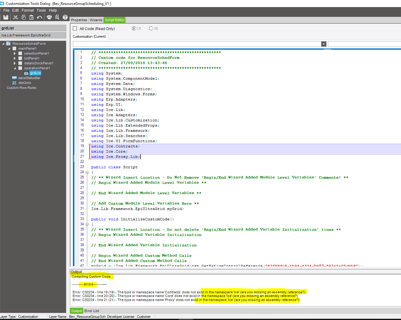

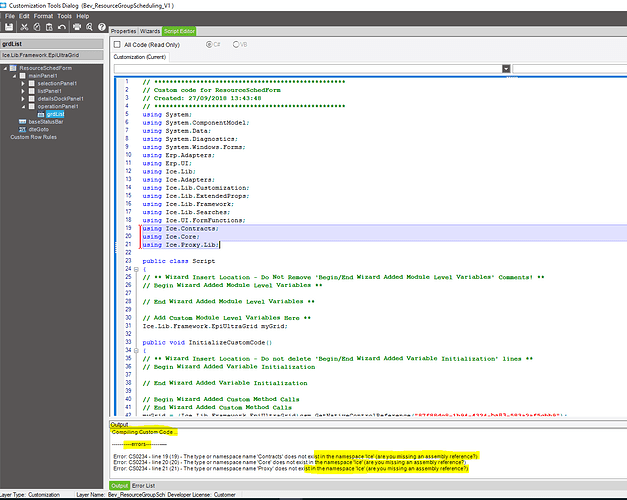

Thanks Dan,
i have tried these libraries (highlighted) and without adding any other code lines it is error out:

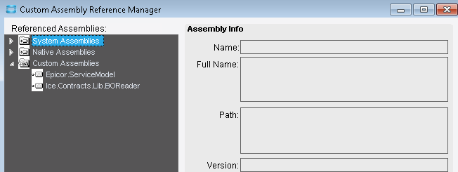

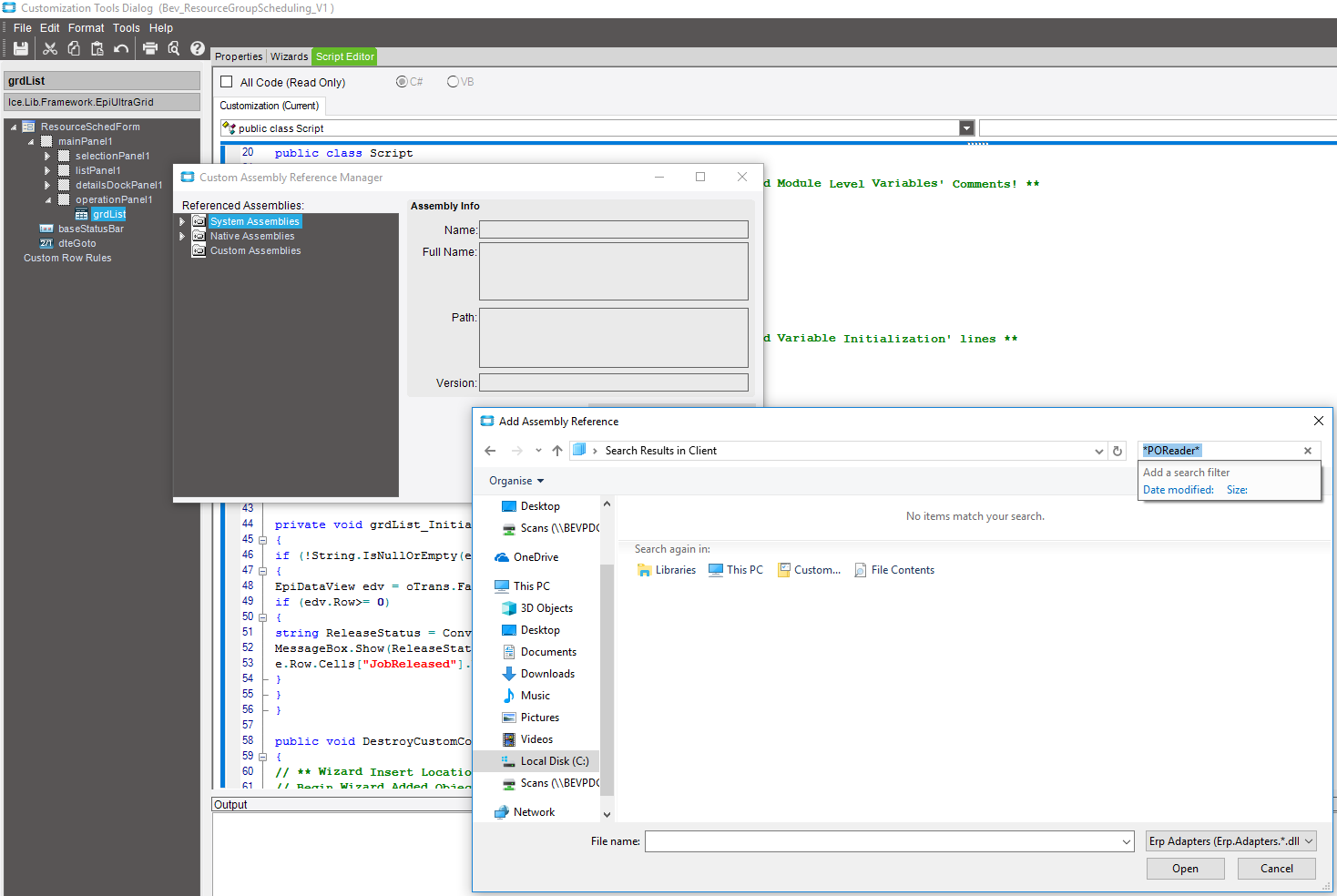

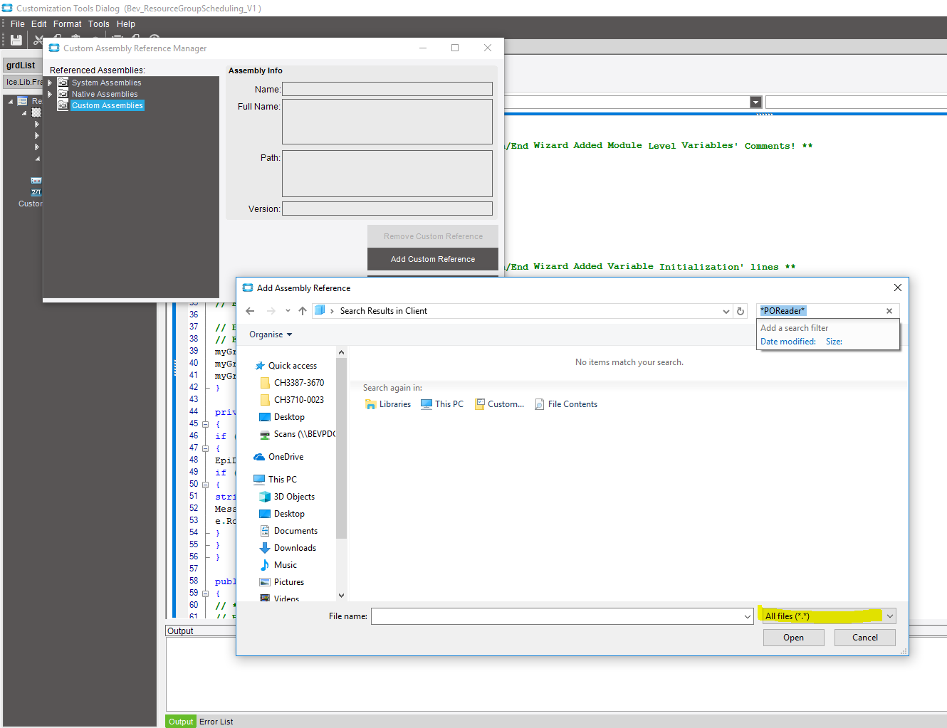

Did you add this reference?
could not find it
Hit this drop-down to look for “All Files”
BOReader not POReader :slight_smile:

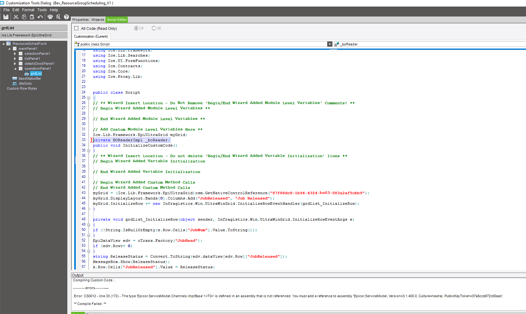

Many Thanks Dan, i found and added the BOReader :):sweat_smile:and The Core, code compiled fine, then start add my custom code and it is error out at
private BOReaderImpl _boReader;
i am testing my code line by line, do i need to add the whole modification and test ?

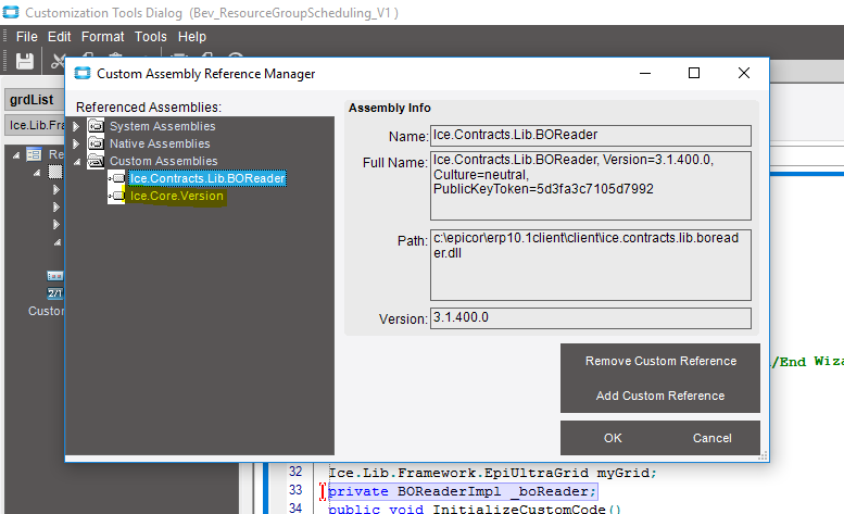

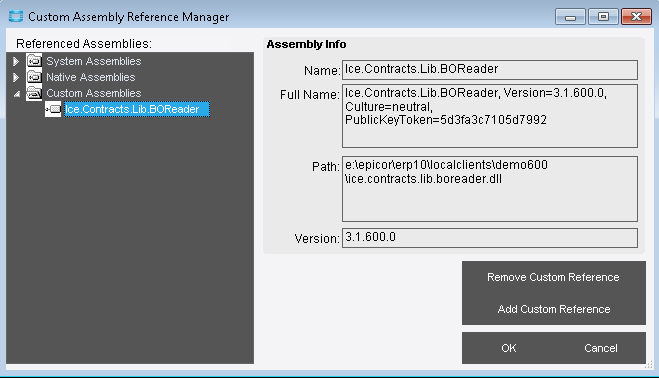

Are you sure you grabbed the DLL from the proper folder (version)?
these the two assembly DLL i added so far
You can remove Core and add this for 10.1.400 and the ResourceSchedForm. Remove using for Core as well.
compiled failed when removing Core, so i have added it back and added what you suggested as well ‘Epicor.ServiceModel’, i have added my custom lines, the whole code complied fine now, however :):tired_face: my added field does not show any value
and this my code, (i am testing this code on Scheduling Resource Tracker Screen as i have manged to add the field but failed to bind it to Epicor DataBase)
