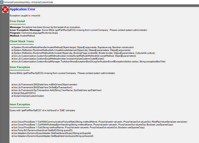

I see that my dashboard also requires a couple of BAQs to help populate the combo boxes. I have added them here. You can just import these BAQs and leave them alone. The customization code takes advantage of the BAQs.
These two BAQs are used by the EditAnyOp Dash. getPartRev.baq (13.5 KB) getPartRevECOs.baq (14.2 KB)

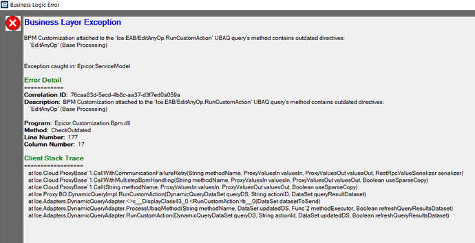

I believe the requirement is at the customization level, and may also be inside the UBAQs BPM.
Apparently, this comes from a module that we do not have in our instance. Is there a way to get a copy of this baq/bpm without that object being mapped?

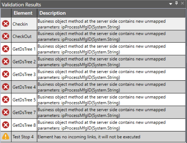

I am not sure on the specifics, but I think that at some point in the last year, a few new key fields were added to some tables. Notably, AltMethod and ProcessMfgID. Once these became requirements, I just pass empty strings for the values, and it seems to work.
To see what changes you might have to make, you have to do a little extra work. You have to add a new method to the BPM for each method that uses those new fields. As an example, open the BPM and go to the bottom. There is a method called CheckIn. Look at the parameters for this method and you should see those two fields (row 4 and 5).
Now go to the menu on the left and find Invoke BO Method. Drag that sucker onto the page next to the CheckIn Method. You don’t have to connect anything just yet.
Configure the new method you added to be setup just like the CheckIn. Click “specified” to choose the BO and method. The Service Name will be EngWorkBench, and the Method is CheckIn. Now click on “not configured” to see the method parameters. Do you have rows 4 and 5 that show AltMethod, and ProcessMfgID?
If you do have those fields, then I am not sure what is going on. You should be able to sue my original files. If you don’t have the fields. Then you can replace my check in method with your check in method. Just make sure to set all the parameters the same.
There are a few other methods in this BPM that use those fields. I think: CheckIn, CheckOut, and GetDatasetForTree, should be the only ones.
This was a lot of work to setup initially, so kudos for diving in! Happy to help any way I can.
Good luck!
For some reason, the ipProcessMfgID wasn’t listed on the Invoke bo methods that came in on the original BAQ. After replacing those with new ones and configuring them the same way you had those errors are now gone.

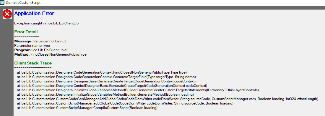

The next error now seems to be with a parameter having a null value:
Is this error from the BPM, or from the custom code in the dashboard?
This section of the customization code on the dash is the only part that I can see that uses type:
I also don’t see any issues with this code. In the dashboard custom code, make sure you have the custom assemblies reference:
Erp.Adapters.EngWorkBench
Erp.Adapters.PartRevSearch
Ice.Contracts.BO.DynamicQuery
These should pull in automatically. You will need that last one for sure to use the function above.
