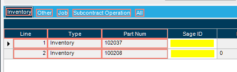

I have a custom field in Part_UD that I want to display as a column in POEntry in the line detail grid. Using the code posted by danbedwards, I am able to get my column to show, but cannot get it to populate with the UD field value. On load, the cells are all blank.
I can get the column to populate with PartNum, so at first I thought problem was related to ERP:BO:Part not being able to call the UD field, but I also can’t get the column to populate with any other field from Part. I tried “UnitPrice” for example: on load the column is blank, but after entering data and tabbing out I get a “Key not found: ‘UnitPrice’ Parameter name: key” error. Interestingly, with the UD field I do not get an error and the field just clears after tabbing out.
Any ideas on how to get the UD field to populate correctly? Custom code below, the UD field I want is Part_UD.SageID_c.

Works perfectly, thank you.
Here’s my full code FFR. To add the field to every grid on POEntry is more code than I thought it would be, and if adding multiple fields it could get cumbersome to the point that it might be better to add a UD field to the PODetail table instead. If the grid is used in two places like it is on POEntry, you need duplicate statements for each using the “-1” control reference modifier or the column does not appear in the second grid location. Interestingly, you cannot use the same column key name in the duplicate grids without getting a “duplicate key” error.
