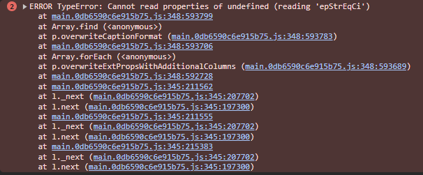

I see this has been posted several times before, and I’ve gone through, I think, all of the posts to see if any of the solutions work. So far, no luck. I added a selector column to the OrderDtl view on the Sales Order screen. I haven’t done anything with the grid itself. I just added a field to the DataView, and I’m seeing the attached error and no order lines show up in the main order details screen. Any other thoughts on what would cause this? This is on version 2023.2

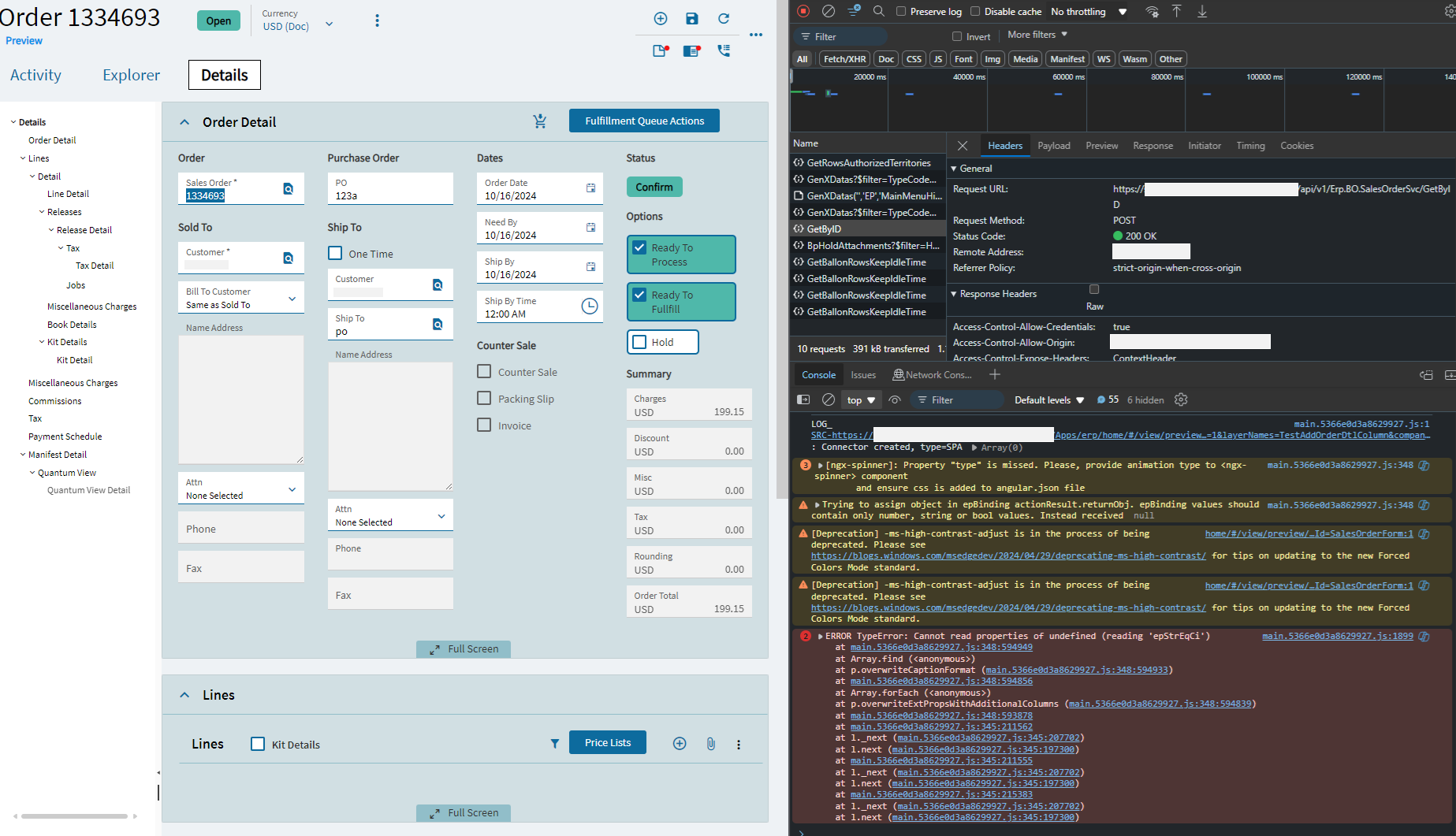

It might help to see where in the event sequence this error happened… and is there an error on a Network action, too?
The network action is SalesOrderSvc.GetByID.
If I start with a brand new layer for SalesOrderEntry, and all I do to that layer is go into the OrderDtl dataview and add a field. Then I run the layer, I get that error, and no records show up in the Lines panel card. Here is a screenshot of the testing window. There are 5 lines on this order that will show up if I remove the newly added field to the OrderDtl Dataview
What’s the response of GetByID?
I guess it does not have your “new” field.
You could do a simple test by adding the column to the dataset/tableset in the GetByID BPM ( Adding Custom column to DataView). Depending on result we could say if it needs to have the same structure or not.

This is where it appears in the event chain when in debug mode.
Looks like a bug.
I was able to reproduce, exactly as you said. Add custom column to the OrderDtl on an otherwise vanilla layer, and it errors.
I also tried as @pawel.malicki suggested to add the field to GetByID with a BPM - confirmed the field is coming back in GetByID, and it still has the same error and no Lines displayed on the Order Details page.
Adding a Custom Column is a totally normal and (usually) simple thing to do … this is just not working. Maybe some calculation is being done on all the data in the OrderDtl table …

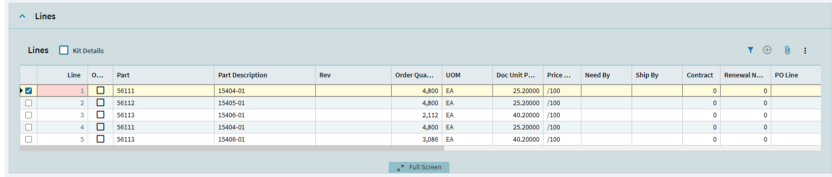

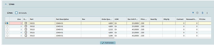

Depending on what you are doing … could you just add a selector to the Lines grid?
In the Grid Model, make the rows Selectable, then you can edit the Selection Options to add a Checkbox
That could work if there is a way to tell which rows are selected. I haven’t been able to find that in all my attempts at Kinetic so far. I can find the last one selected, but not all of them. All of the posts on this I’ve seen say add a field to the original dataview, but that is where I run into the problem.

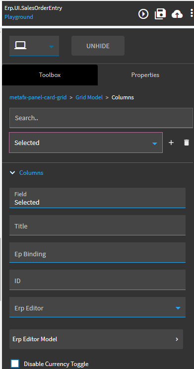

You should be able to add it to the grid without adding it to the data view:
I followed the attached article, and I still run into the same problem. I am able to add the checkbox to the grid just fine. When executing the dataview-condition statement it doesn’t iterate through the grid. I’m assuming this is because the “Selected” column doesn’t exist in the dataview. I was wondering if there is a special column or special way to grab the selected rows from the grid. So far I haven’t found it

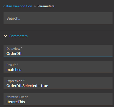

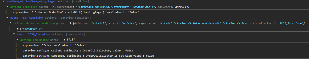

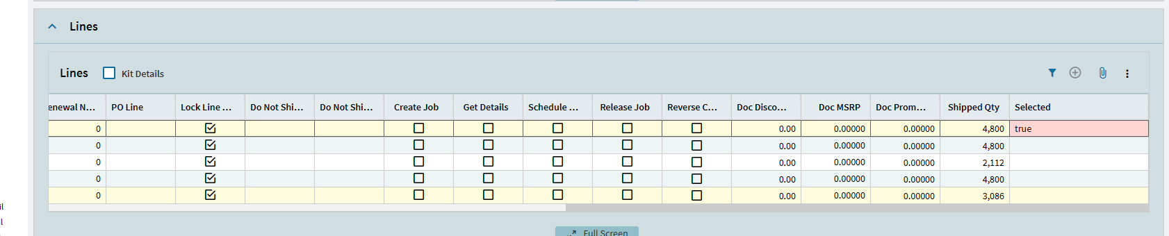

I got it to iterate through the grid of OrderDtl lines - and it only performs the iterative event on the selected data
Note the expression: OrderDtl.Selected = true

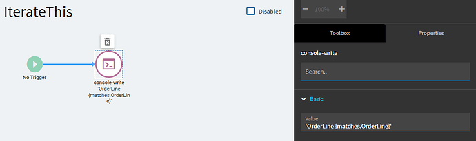

Here’s my dataview-condition widget:
and my iterative event:
I kept it simple just as proof of concept … it should work on the OrderDtl Lines grid on the Sales Order Details page - without adding a column to the data view

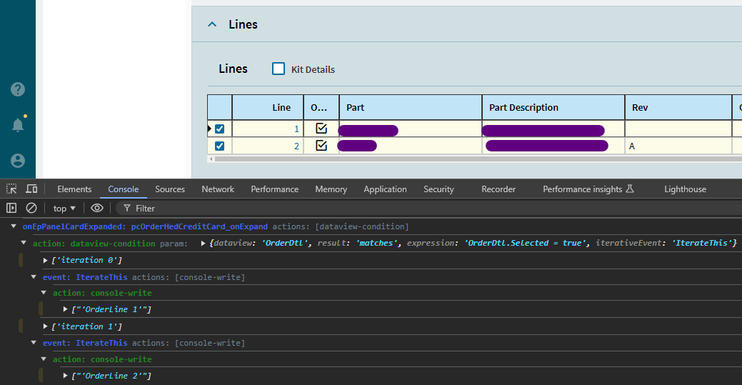

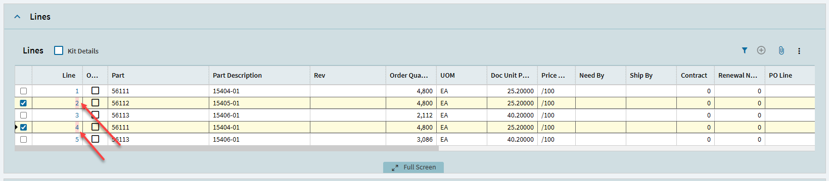

It only iterates over the last line selected for me, not all the lines selected.
Showing that it should iterate them all:
Show us what you’ve got … maybe we can find you a solution
Thank you very much for your encouragement so far. I was able to get it to iterate multiples by changing my test. What I’ve found is that it doesn’t iterate over all of them about 10% of the time, and my test was falling within that 10%. I tried it with other tests and it iterated over all selected items. I’ll see if I can figure out why it isn’t doing it in some cases and report back if I find it, but thanks again for persisting with me.

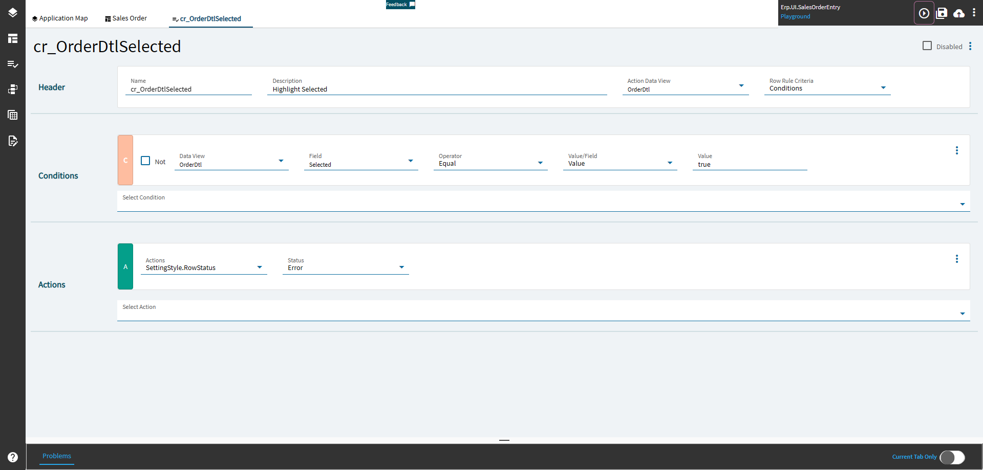

It doesn’t need to exist in the DV for it to work.
It won’t show up with “intellisense”, so you’ll have to type it in yourself, but it works.

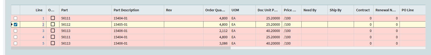

This is the only setup I did:
And it highlights. However, the real crime here is the “highlighting.”

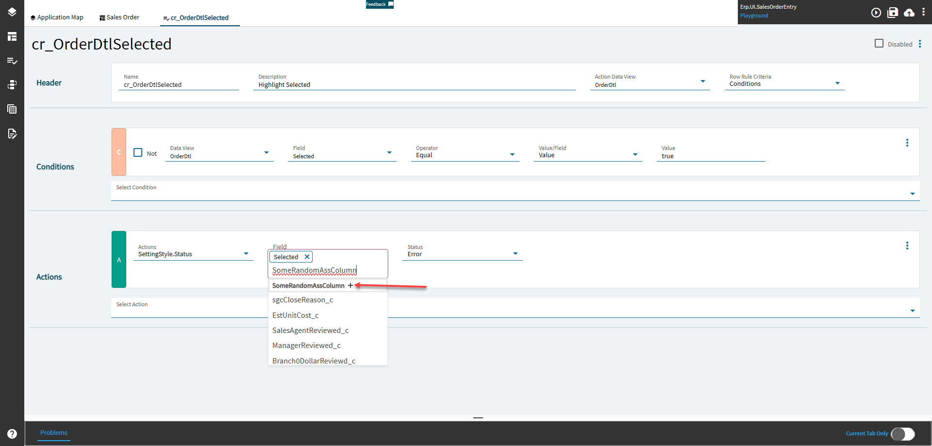

Interesting, I will try again. I had been trying to do the type of row where you select multiple columns in the actions area and it wasn’t letting me just type them in.
That should work too. It’s supposed to give you a + icon if it doesn’t exist in the DV.
I guess the crime lies with the SettingStyle.RowStatus.
Individual column highlighting looks okay.
Ah, okay. It appears it’s the selection highlighting overruling the row rule highlighting.
