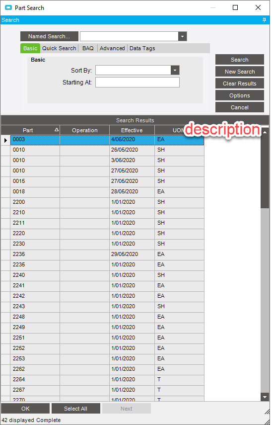

Our purchasing team ask me if I can modify the search result in the Supplier Price List Program when the user searching for Part after selecting the Supplier. All they want to see is the description of the Part in the search result. I tried doing a Quick Search, but the search isn’t so easy to do as the Part button is enabled after the supplier has been selected. What is the simplest way to achieve this?

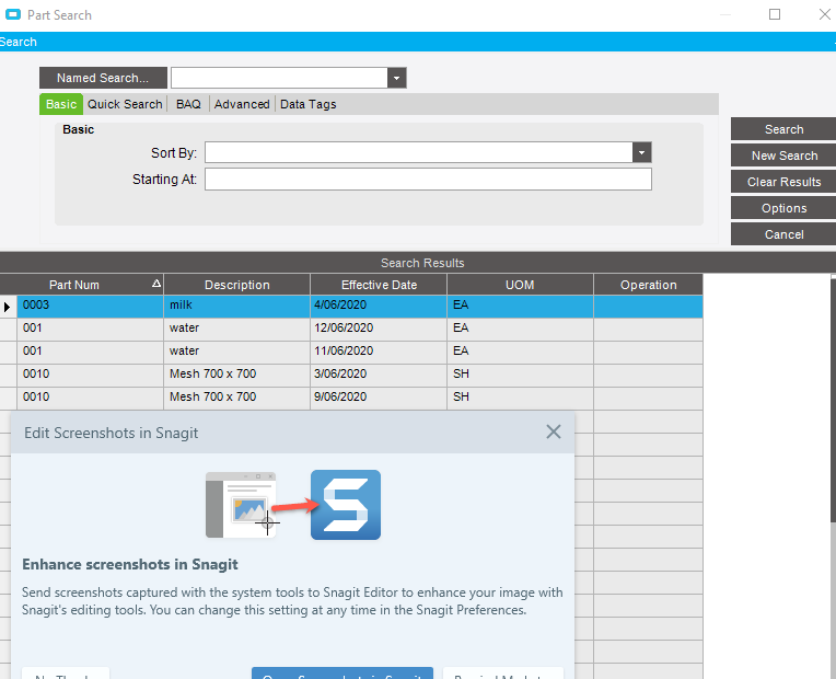

This code does work, however, I cannot explain why there is an additional column called Operation that concatenated into the 5th column… Any ideas?

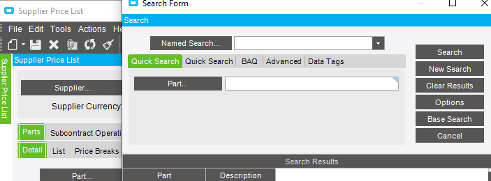

I tried quick search it worked for me.
created BAQ using “Erp.VendPart” table, selected “partnum” and “description”
Created quick search in the supplier price list and suppressed the base search.

It does work, but there is the extra Operation Column in the result, that is the part I don’t understand.

In The Supplier Price List Maintenance, when you add new part, the new part will have the associated VendorNum into the VendorPart Table. The structure of that particular screen is quite hard to customize, but for now, I just leave it as is with the OperationText Column as it doesn’t hurt to have it.
