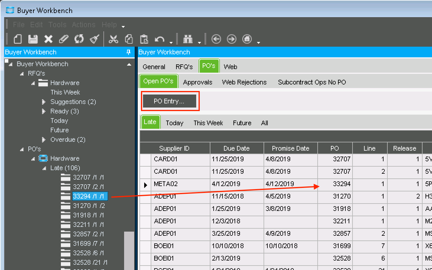

I have added a UD Field (cBuyerDueDate_c) to the PO Release table (Erp.PORel). I want to add it to the grid views on the Buyer’s Workbench. @josecgomez has a great YouTube video on how do do this by replacing the existing grid bindings with a BAQ result set (thanks Jose!). After replacing three of the PO related grids on the Workbench using this method, I realized that they no longer sync with the Tree View–the user cannot select the PO on the Tree View and have it navigate to the same PO on the grid view. I also discovered that the PO Entry… button no longer opened the selected PO
(Epicor standard functionality)
I figured that I might be able to replace the existing button with a custom button and get that to work with the new grid views, but fixing the tree view appears to be a rabbit hole. I could ask my users to ignore the tree view and use right-click/Open With… and I might resort to that. I thought, however, that I would at least try the other suggested method, which is to create a new column in the grid and use the BOReader assembly reference to populate it on the fly. I realize from the feedback on this site, that this method is inefficient and may have performance issues.
